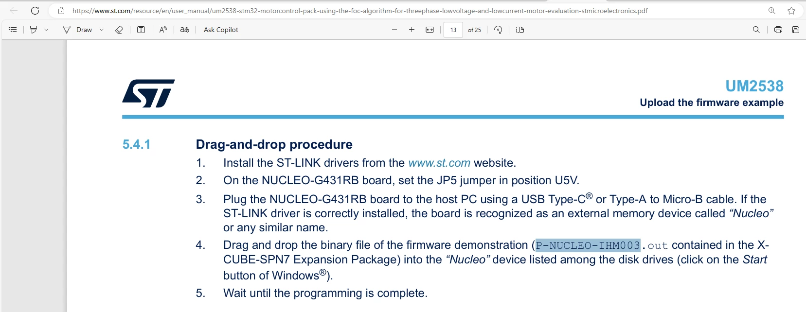

Hi, where can I find the firmware demonstration P-NUCLEO-IHM001.bin mentioned in the manual for STM32 Nucleo Packs P-NUCLEO-IHM001?

You will find the binary in X-CUBE-SPN7 in folder
Projects\Multi\Examples\MotorControl\Binary\P-NUCLEO-IHM001

In Manual, its written for P-NUCLEO-IHM003 as well, it is present there but i cant find it.

I found the binary file, but I am not able to load it to the Nucleo board. I am following the "Drag and drop" procedure, so I have the jumper JP5 in U5V position, and I would need to drag and drop the file into the Nucleo device that I see listed among the disk drives. However, the disk drives list shows that the Nucleo has a total space of 32 KB (used space 12 KB). The binary file P-NUCLEO-IHM001 is 64 KB, so I get a "not enough space" message.
Is this a problem with the drag and drop procedure, or am I missing something?

Correct, JP5 should be in U5V position, JP6 set and CN2 (ST-LINK) with jumpers on. Drag and drop is a usable method, as is copy and paste.
Please double check whether you have a NUCLEO-F302R8 with an STM32F302R8T6 on board?

MDe L.3AuthorBest answer
August 10, 2021
I fixed the problem. When the Powerboard is connected, it shows that the Nucleo device has 32 KB. But, if I disconnect the Powerboard, then it has 220 Kb and I can drag and drop the file. It works! Thank you for your help!
