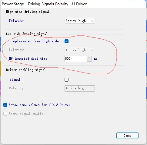

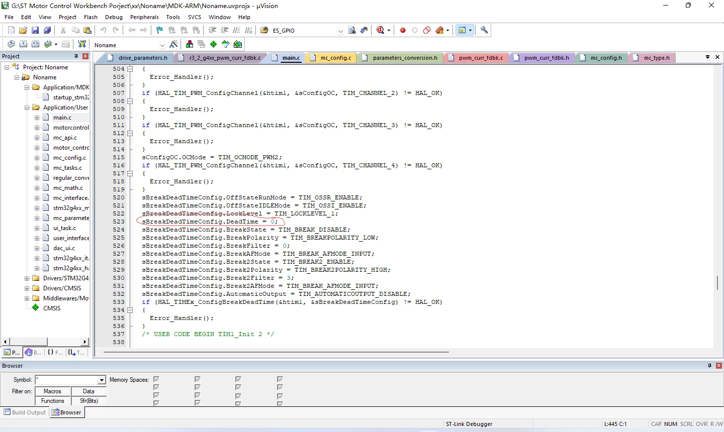

Hi, in the Power Stage-Driving Signals Polarity tab in Workbanch. I enabled Complemented from high Side and set HW inserted dead time but I don't know where this is reflected in the program.

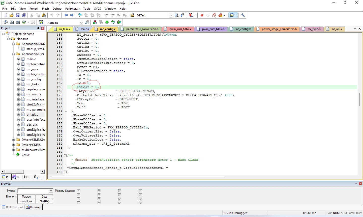

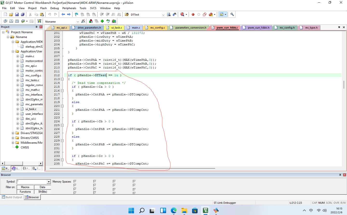

当此模�?打开时,计时器的死区时间设置为零
DTTest 零�?能直接在 SVPWM 中�?�入死区时间;
所以我没有找到一个程�?用于在这�?模�?下�?�入死区时间。
如果您能帮助我,我将�?胜感激
