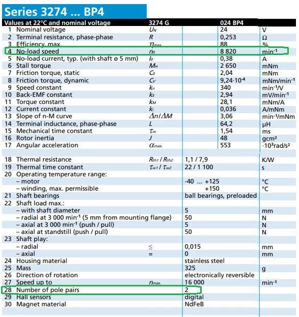

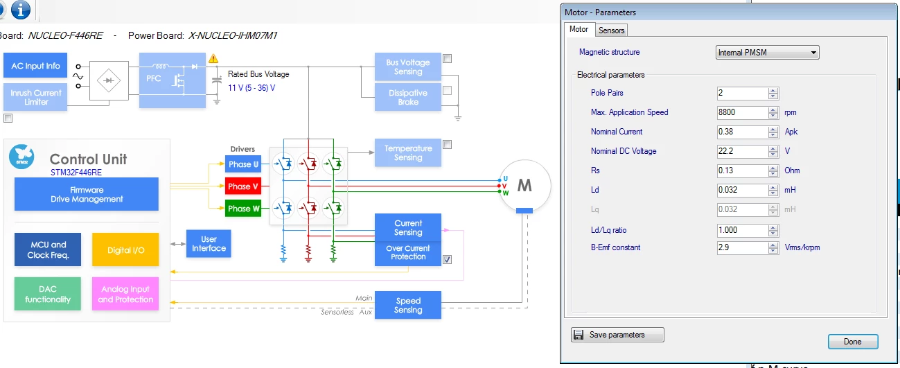

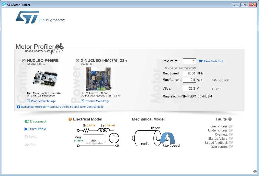

I'm just starting to control a BLDC motor and I bought the X-NUCLEO-IHM07M1.

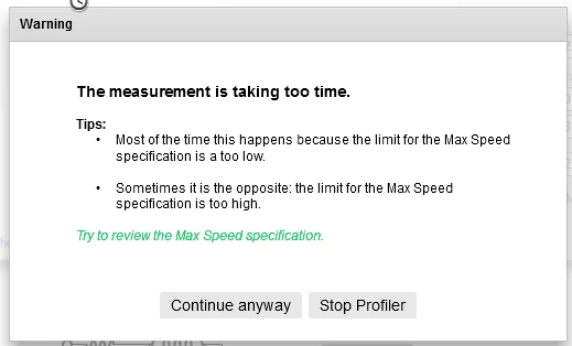

The main issue is that the software Motor Profiler give me an error when it try to configure the Faulhaber motor 3274BP4 (attached the motor specs).
The jumpers configuration in the control board are:
J6 - 3Sh selected
J5 - 3Sh selected
JP1 - Closed
JP2 - Closed
JP3 - Open (I'm not using the hall sensors yet).
J9 - Closed (I assume this jumper is to power the NUCLEO-F446RE from the motor controller).
Somebody can help me if I need to make some electronics modifications in the motor controller boards to detect the BMEF? What I'm doing wrong?
