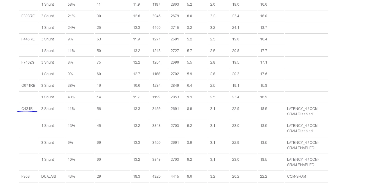

Hello, i'm working with the EVSPIN32G4NH evaluation board to control a brushless motor. I cant find it on any ST Software. Does anyone know where i can find it? Thanks

https://www.st.com/content/st_com/en/ecosystems/stm32-motor-control-ecosystem.html
St provides a motor control workbench and a motor profiler, there is a chance your specific board is not supported, meaning that you need to add up all the details from EVSPIN32G4NH by hand, tedious but possible

thing look good for you , the stm32g431 is supported in the FOC library

Hello Javier, Thanks for the quick response!
How do i add the STM32G431 to the library in th workbench ?
