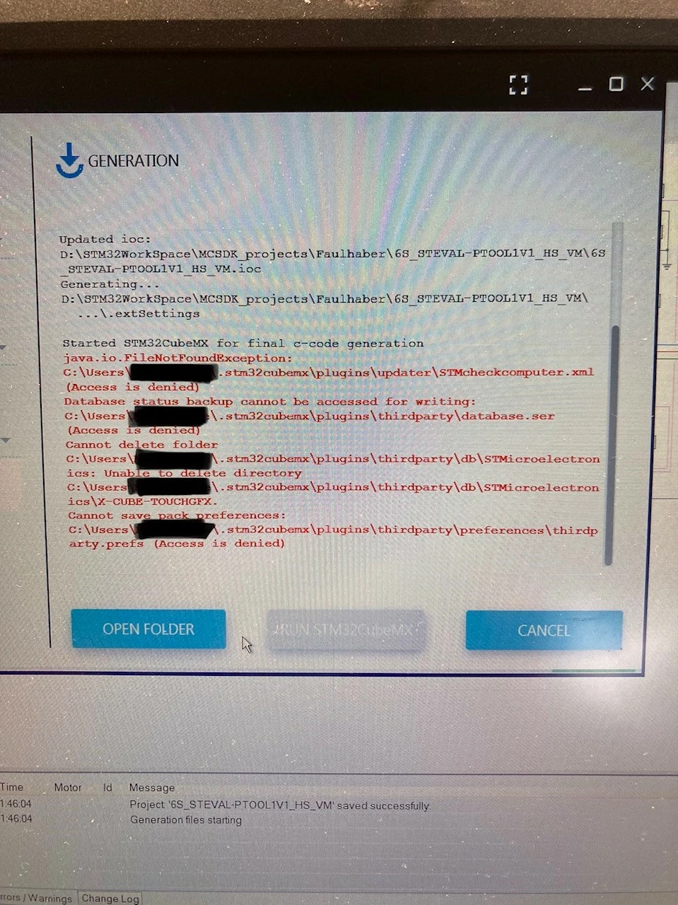

Hello. I encountered an error in the image when generating the cubeMX file from the MCSDK. I checked the user-access rights and found everything to be fine. No one has any idea what could be the cause of the error message? Thanks in advance. Bela

Hello @BPara.1​,
Thank you for posting on the community forum,
I could only reproduce the issue you encountered by denying permissions to the ".stm32cubemx" folder. Could you please check if you have full control allowed on that folder ? If so please check the existence of the files mentioned in the error message and update me with your findings.
