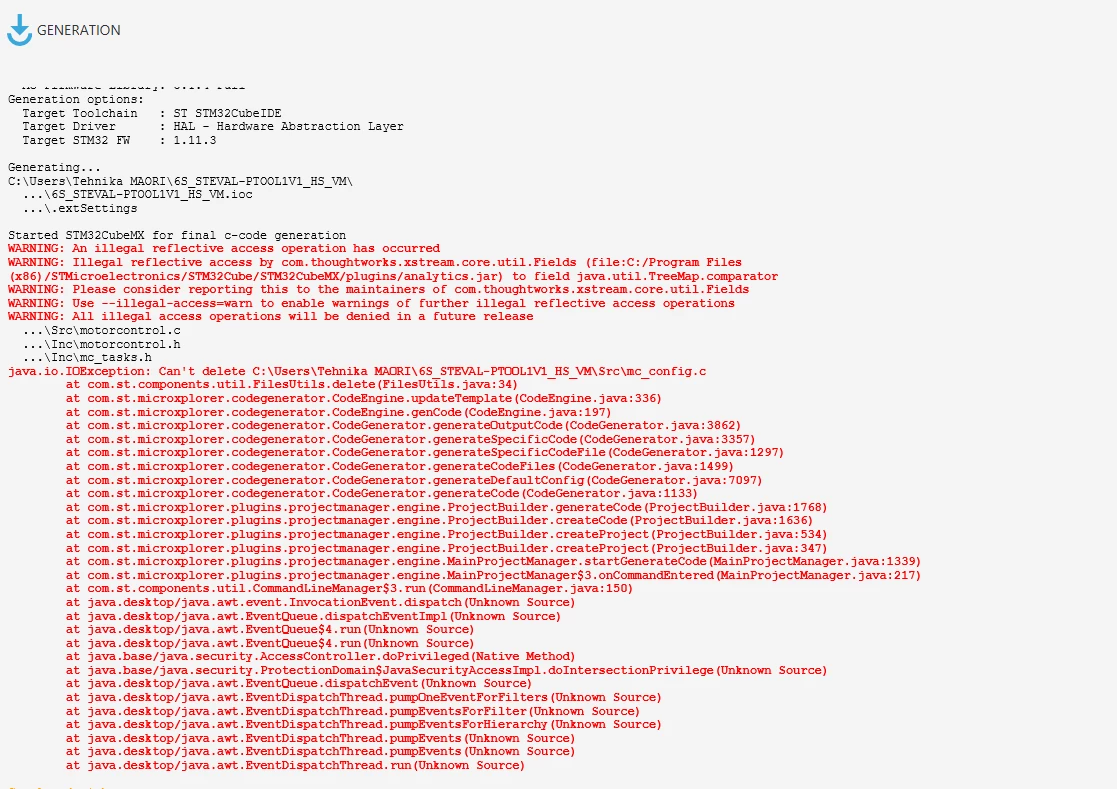

Hello, I am working on project with STSPIN32F0, and when compiling example in ST MOTOR CONTROL Workbench (version - X-CUBE-MCSDK_5.Y.4) I get errors which cannot be resolved? See errors in the picture below and log file attached.

It is possible the framework can't correctly handle a space in the path.
It says it can't delete a file. Go see if you can or if something is holding it open.
