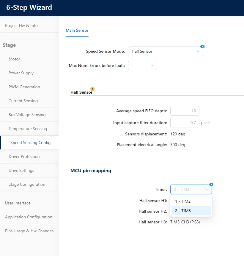

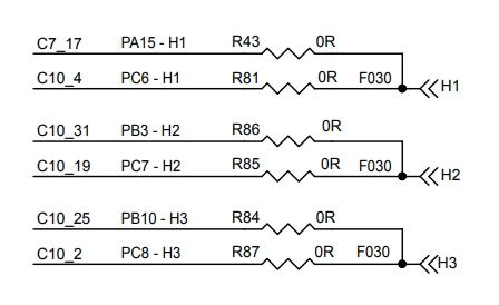

Fabrice LOUBEYRE
June 5, 2025
Hi All, one of the changes made into the new MCSDK WB 6.4.0, is the ability to choose the timer number used to catch the HALL inputs
By default, the timer selected is the Timer 2, that could be different of the one used into MCSDK WB 6.3.2.
Naturally, another timer choice will generate different PINs for the H1, H2 and H3 signals, and in consequence a problem of connection if boards have been modified in desoldering access to the unused HALL signal connections for example.
MCSDK WB 6.4.0 HALL timer setection
i.e IHM16M1 HALL possible connections
Best regards.
Fabrice

I checked and that's not the issue for me. In either my custom board or IHM08M1 the Hall inputs can only be connected to a timer so there is no choice.
