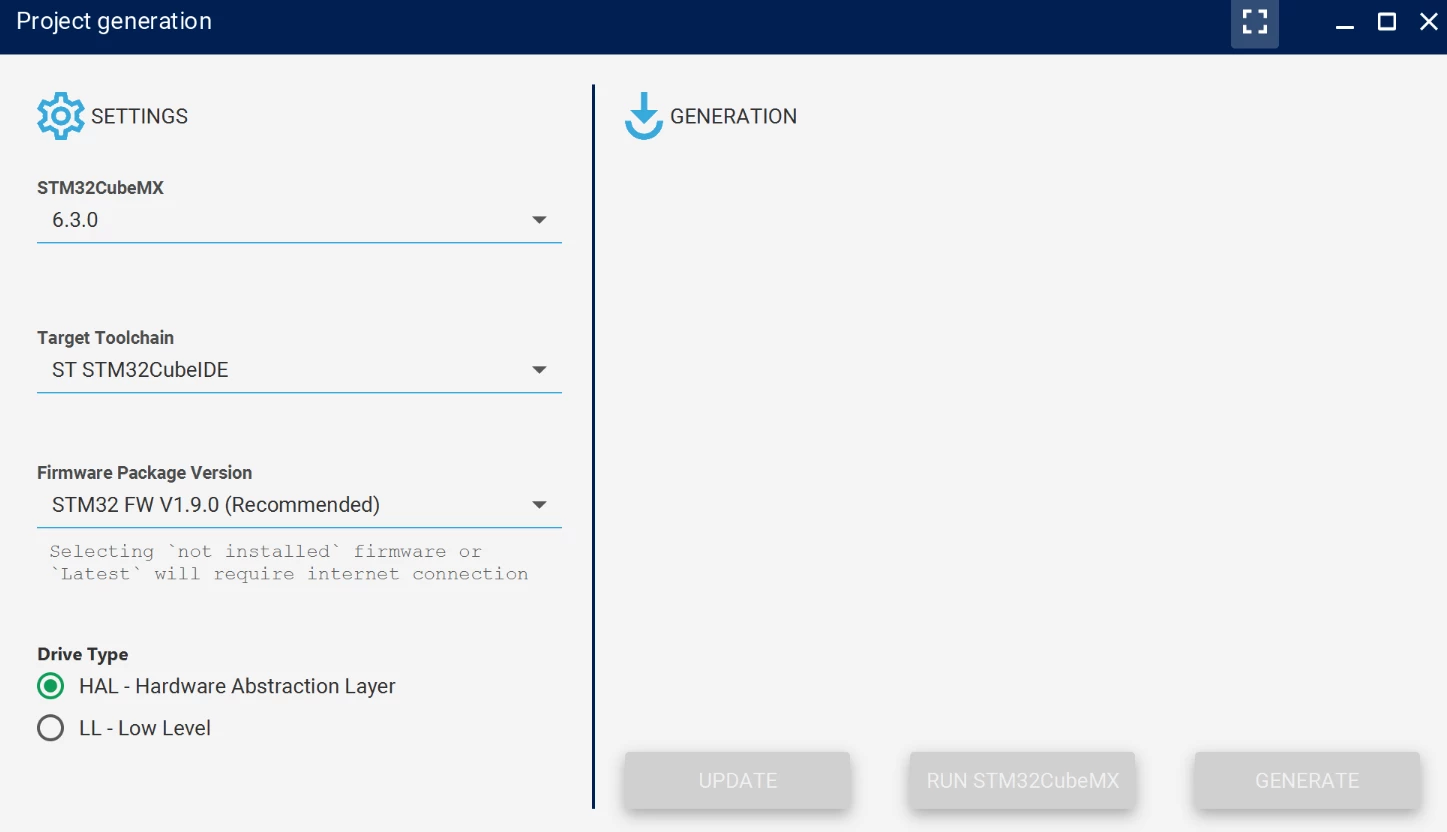

Hey there,
I'm trying to generate code with the Motor Control Workbench V5.Y.3 for the Nucelo H745ZI.
I selected the sample project in "Projects\NUCLEO-H745ZI\..." saved it somewhere else and tried to generate code.
In the project generation dialogue all three buttons (Update, Run STM32CubeMX, Generate) are greyed out. (I'm still on CubeMX V6.3.0)
Does anyone know how to fix this?
Or how to use an H7 processor outside of this example project?
The log file just shows this:

SAlru.1
SAlru.1Author
Hey @Laurent Ca...​ ,
I was sadly unable to fix this problem in any way. I've tried i on several different machines and the legacy Version 5.4.7, but the problem persists.
I noticed, that the example is missing the ".wb_def" file and additionally the MotorControl Folder referenced in the ".ioc" file is still a development source:
ExtraMW.MotorControl.Root=MotorControlDev/
the other examples I've checked all reference:
ExtraMW.MotorControl.Root=MCSDK_vX.X.X/MotorControl
So my best guess would be that the example is still in an development state which breaks the code generation. (just changing the folder does not fix the problem)
Could you please check if the example can generate code for you, and if not report this issue so it will be fixed in a future release?
