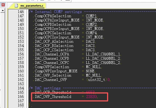

Hello @Garey,
DAC_OVP_Threshold is defined but not used.
Bus Voltage sensor thresholds are defined in drive_parameters.h file
/************************** FIRMWARE PROTECTIONS SECTION *****************/
#define OV_VOLTAGE_THRESHOLD_V 29 /*!< Over-voltage threshold */
#define UD_VOLTAGE_THRESHOLD_V 10 /*!< Under-voltage threshold */

Hello @Garey,
As displayed on the Workbench interface, VBUS is not compared to a DAC-generated value using an internal comparator, as is the case for Over current protection on Current Sensing. Instead, the comparison is performed by firmware.
The DAC_OVP_THRESHOLD parameter is set to a default value.

Are you saying that 'DAC_OVP_Threshold = 23830' actually has no effect?

Hello @Garey,
The overvoltage protection is managed by the firmware in the r_divider_bus_voltage_sensor.c file.
The overvoltage protection with DAC comparison feature is not available.
