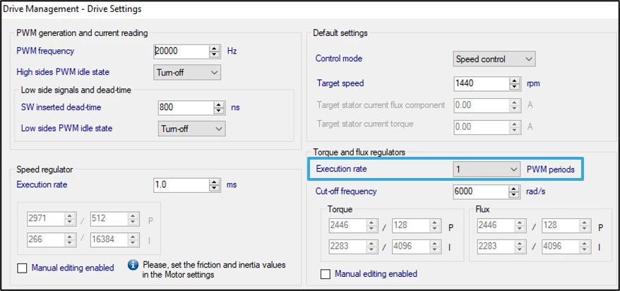

I have created a motor profile using the motor profiler and confirmed the hardware is working correctly. I have then attempted to create a position control project using the AN5464 as a guide. I have got to a stage where the motor doesn't rotate at all. I have tried to debug the code and I have realised that it gets stuck at the "while(MC_GetAlignmentStatusMotor1()!=TC_ALIGNMENT_COMPLETED){}" line of code. I have attached a PDF showing the value returned by the function.
I have then tried to connect to the board via the monitor in the motor control workbench and it shows FOC duration and Software error as soon as the MC_StartMotor1() function is called. Does anyone know what's going on?

Hello @msingh​,
The new PWM duty cycle is calculated and has to be computed before the next PWM cycle starts. If the duty cycle is set too late to be taking into account in the next PWM cycle, a FOC Duration error occured.
Timings in the motor control algorithm are critical, please be sure to build and run your project with STM32Cube IDE in release mode with optimization O-Fast.
Fix your PWM Frequency and increase your delay between each FOC loop, you can increase 1 by 1 the Execution Rate parameter until the FOC duration disappear.
FOC loop is executed at PWM Frequency / execution rate
Best Regards,
Antoine

I have an update on this, Reducing the PWM frequency has helped to remove the FOC duration and Software error. However, the motor is still not able to rotate, I can see the current increasing as the motor is supposed to rotate but the rotor never moves.
