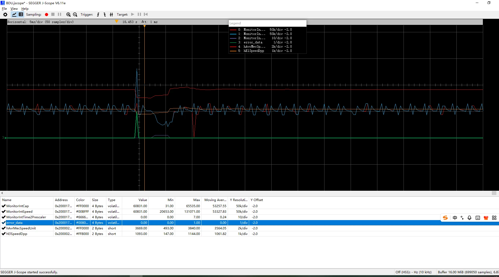

I encountered a problem where I used ST's open-source FOC algorithm. Currently, my motor often shakes at a speed of 22k. Upon inspection, I found that the Hall output of the motor has some fluctuations, which is a problem with the motor itself. However, the important issue is that when the timer input captures the Hall sensor signal, there is a problem where both the capture value of 65535 and the overflow flag exist. As a result, the calculated capture value becomes 65535+65536, causing shaking. I think it's because when 65535 was captured, the program didn't process the callback function in a timely manner and only processed the timer callback function after overflowing. What if we solve this problem?
As shown in the blue curve in the figure below, when a peak appears, it is an abnormal moment:

Hello ​@Jaime1024,
According to the Interfacing with Hall sensors chapter of the MCU reference manual: The slave mode controller is configured in reset mode; the slave input is tim_ti1f_ed. Thus, each time one of the 3 inputs toggles, the counter restarts counting from 0.
You can try, in the SPD_HALL_TIM_M1_IRQHandler() function, process the CC flag first. Then clear the CC and UPDATE flags at that point.
You can also check the HALL signals at the low-pass filter output, if present.
If you agree with the answer, please accept it by clicking on 'Best answer'.Best regards.GMA
