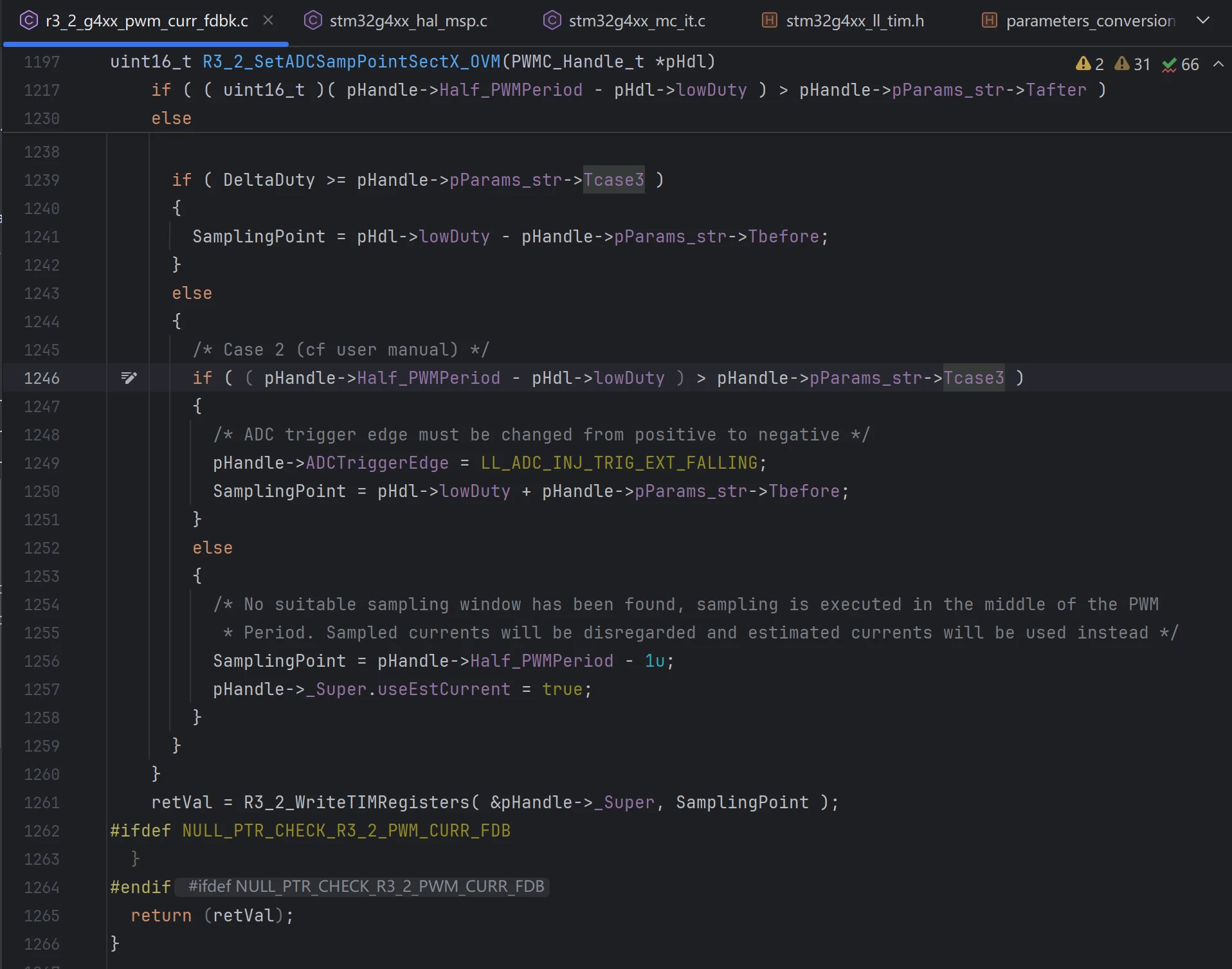

Foc 3 Shunt Current Sensing Bug Report
MCSDK Version: 6.4.1 Build: 250722.224358
uint16_t R3_2_SetADCSampPointSectX_OVM(PWMC_Handle_t *pHdl)
Line 1246.
Should there be Tcase2?
Tcase3 here is wrong, Tcase2 with no caller.
GMA
GMABest answer
Nov 17, 2025 9:13 AM UTC
Hello @LahmYang,
Thank you for your report. The corrected firmware is as follows:
 uint16_t retVal;
 /* In every sector there is always one phase with maximum complementary duty, one with minimum
 * complementary duty and one with variable complementary duty. In this case, phases with variable
 * complementary duty and with maximum duty are converted and the first will be always the phase
 * with variable complementary duty cycle */
 if ( DeltaDuty >= pHandle->pParams_str->Tcase3 )
 SamplingPoint = pHdl->lowDuty - pHandle->pParams_str->Tbefore;
 else
 /* Case 2 (cf user manual) */
 if ( ( pHandle->Half_PWMPeriod - pHdl->lowDuty ) > pHandle->pParams_str->Tcase2 )
 /* ADC trigger edge must be changed from positive to negative */
 pHandle->ADCTriggerEdge = LL_ADC_INJ_TRIG_EXT_FALLING;
 SamplingPoint = pHdl->lowDuty + pHandle->pParams_str->Tbefore;
This issue will be reported to the dedicated team to address and correct it for future deliveries.
