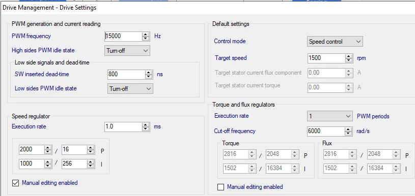

The motor runs fine even at 8000 RPM. The problem is that under small load of 2 kW (48V, 50 A DC, 4000 RPM), after 1-2 minutes of constant speed, a MOSFET burns through with an explosion, although the temperature at the inverter stage is only around 40°C and the FETs are cooled through a thermopad (1mm thick, 12 W/mK) and pressed onto a water cooled aluminium body. The cooling should be more than sufficient, as the same cooling system works fine on a motor controller from the competition with the same motor under full load (12 kW, 200 A DC) for 10 minutes and FET temperature <80°C.

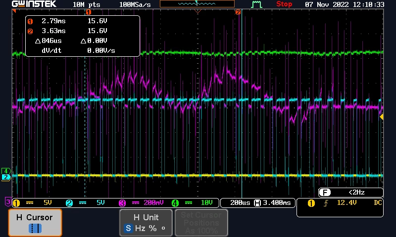

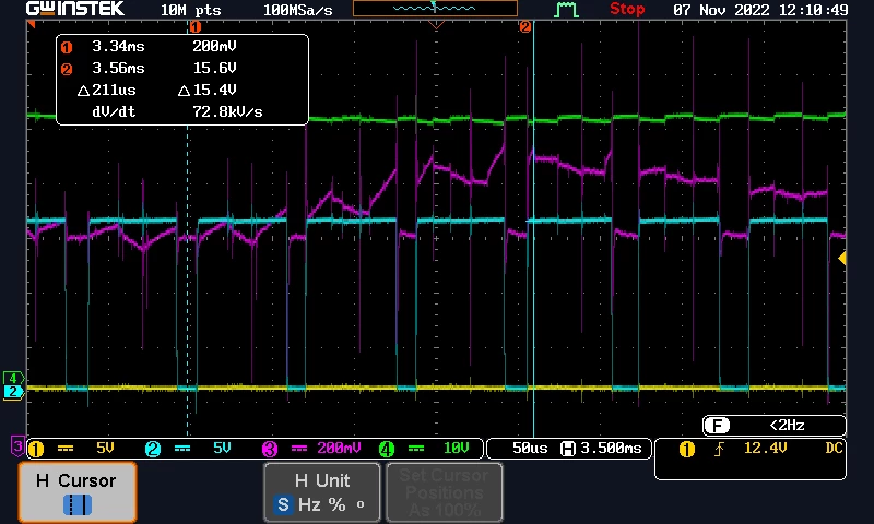

I am trying to find the cause for the MOSFET burning. Could it be caused by bad current and flux PI regulator settings? The settings I use are automatically calculated parameters from the workbench, I didnt tune them myself and they can be seen in the screenshot above. The motor runs smooth though. I can provide a current reading of one of the OPAMP outsputs from the current measurement during operation (pink color):
0693W00000WHyuaQAD.png0693W00000WHyv4QAD.pngINFO: the huge voltage spikes during switching are caused by long measurement wires and are not "real".
Could any other wrongly-set parameter cause excessive heating or switching losses of the FETs that could lead to mosfet burning ?
