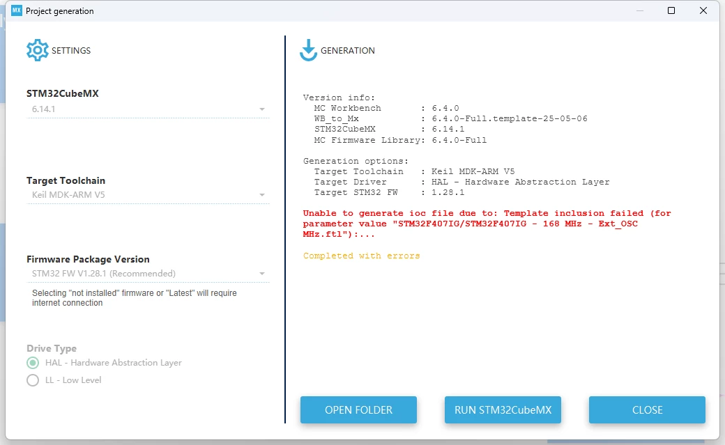

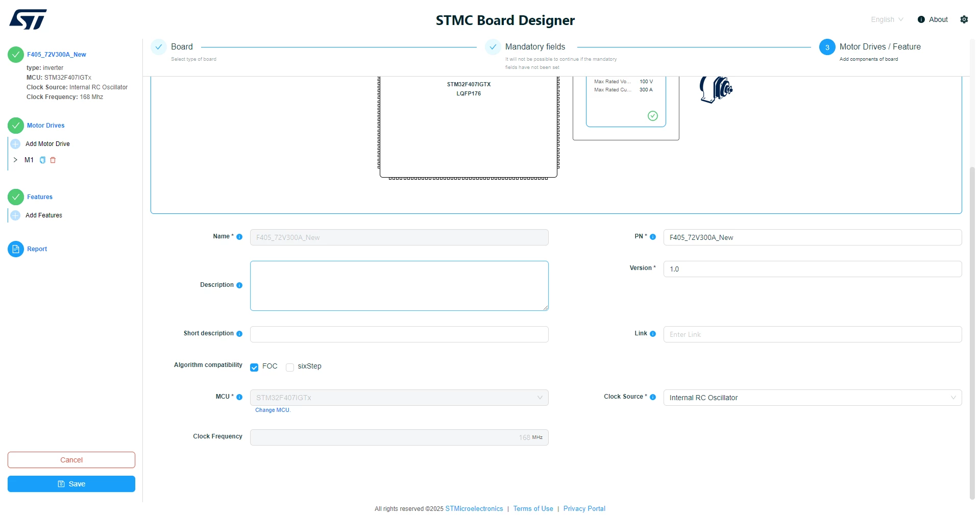

Hello, I am currently creating an inverter using STMC Board Designer, the MCU is STM32F407IGT6,the clock source is internal clock, here are some screenshots of my configuration, it was working fine until the inverter was generated successfully, and when I have everything ready to create the program, I get an error as shown in the picture below.I have version 6.4.0.I'm desperate to know why I'm getting this error, thanks.

Hello @iskan,
Thank you for the report. The issue comes from that Clock Source=Internal RC Oscillator is not supported by the Workbench for STM32F4 series (to be solved on next release).
Selecting External Crystal clock as Clock Source should solve the issue.
If you agree with the answer, please accept it by clicking on 'Best answer'.Best regards.GMA
