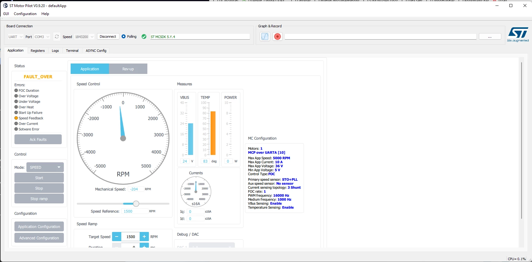

Hello
I updated the motor parameters as per the motor's datasheet. Both in the motor workbench as well as checked the appropriate header files. All the information and specs are correctly loaded in the IDE.
Here is the motor description: https://lin-docs.s3.us-west-2.amazonaws.com/datasheets/external/bldc/BL17E19-01D-03RO.pdf
However, the error I get is startup failure. The code flashes correctly in the MCU but the motor just hums and runs for almost 1-2 seconds, and stops and shows failure. Even when I modify the code to run it using the MC_StartMotor1(); command.
I saw another post here on the forum that F446RE and similar MCUs (like F401RE) have a pin assignment issue and an ST employee suggested cutting the C10 - 18 pin on the MCU since that is the VCAP pin and changing the pin assignment. I want to know if that is relevant to my MCU+driver combination. Here is the post link:
https://community.st.com/s/question/0D53W00001AzMDESA3/environment-mcsdk-5y2-stm32cubemx-630-nucleof446re-is-not-working-compared-to-other-nucleo-boards-while-using-the-same-power-board-bldc-motor-with-the-same-configuration-what-would-be-the-possible-cause-for-this-problem
Also, what is the best way to resolve this issue? I am stuck and looking forward to some help.

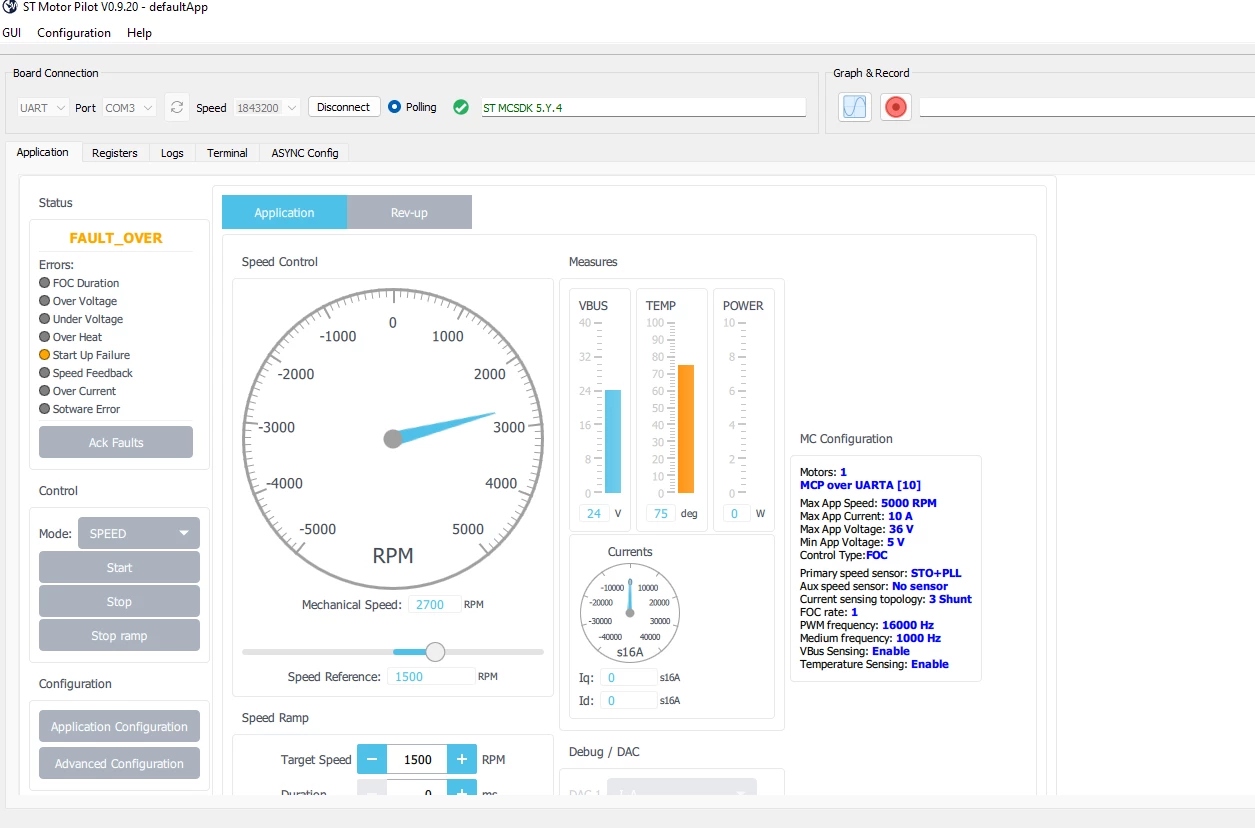

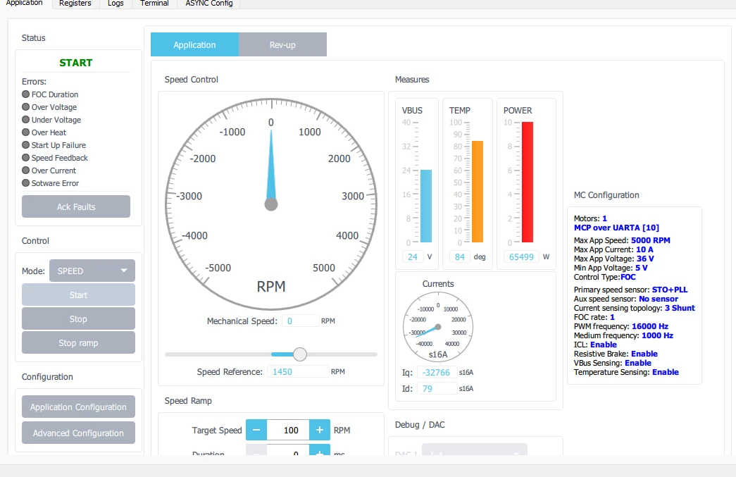

Hello
Here is an update:
Whenever I run the motor using the motor profiler tool, the following happens.
You can see the power measure is off the chart up to 65kW. I don't think that should be correct. But I don't understand why this happens.
Regards
Anirudh

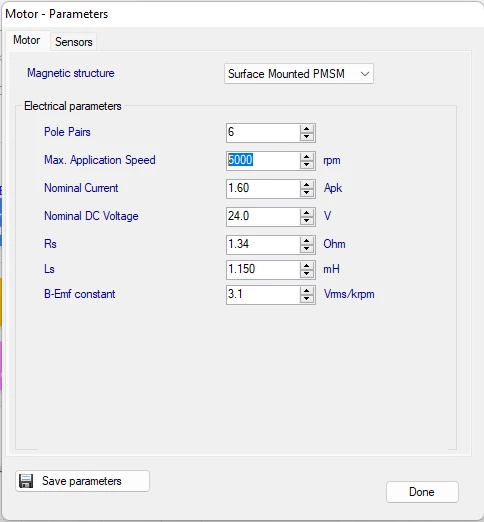

GMA
August 22, 2022
A short remark, it is mentioned in Motor specification document "Pole Number 6", I assume that it means 3 Pole Pairs...
In Motor Setting WorkBench, "Pole Pairs" is set to 6.
Did you try with 3?

AChha.1
AChha.1Author
August 22, 2022
Hello, I tried using 3 pole pairs, and I get the same error - Startup failure. I think I did that before as well because I was confused about the specs too but I did it again and it throws the same error.
Regards
Anirudh
Edit: The only difference is that when I select 3 pole pairs, it seems to spin more aggressively as it starts but then again the humming and full stop. Startup failure.
However, thank you for pointing that out. I did check the pole pairs manually, by shorting the two phases and I could feel 18 bumps/clicks.
18 --> 3 phases = 6 poles = 3 pole pairs.
My understanding is correct, right?

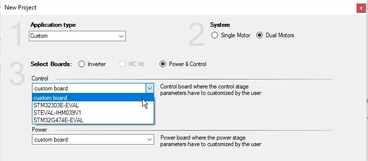

GMA
September 7, 2022
Using WB5.4.8 e.g., you can choose Dual Motor configuration. You will have a set of available control boards for that purpose:
0693W00000SujgzQAB.pngGenerating the code, the dual motor api will be visible in mc_api.c.
3 motors are not supported by the workbench for the moment.
Best regards.
