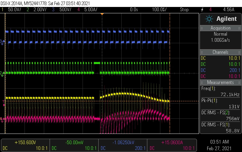

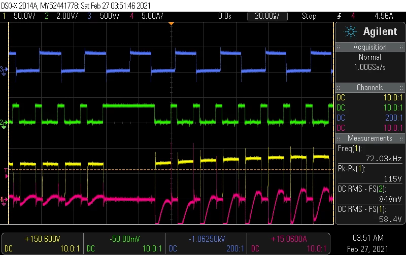

I'm builing a photovoltaic power application using the F334R8, but i'm having issues with HRTIM1, TIMERA/TIMERB output. Attached are scope outputs.
CH1 the main power switch Drain-Source voltage, CH2 is the signal comming from the STM32F334R8 HRTIMA (or B) - which drives CH1; CH3 is the output of the high voltage side of the inverter (TIMC/TIMD) and CH4 is the current through an active clamp converter - synched with CH1...
The problem is: The output from TIMA/TIMB can sometimes randomly gets higher than 100%! (as shown on CH2).
HRTIMA/B configuration seems to be correct - also i'm enabling shadow registers - and the code to extract those waveforms are running an open-loop soft-start duty increase *** only ***....
It's very weird and very random, so the question is: what should I check on the STM32 side? code? hw? power-sources?

I did manage to solve this issue.
The +3.3V was picking some noise from inverter high frequency switching.
So, when the +3.3V had a tiny increase due to HF noise, somehow the HRTIM1 gives this weird output.
