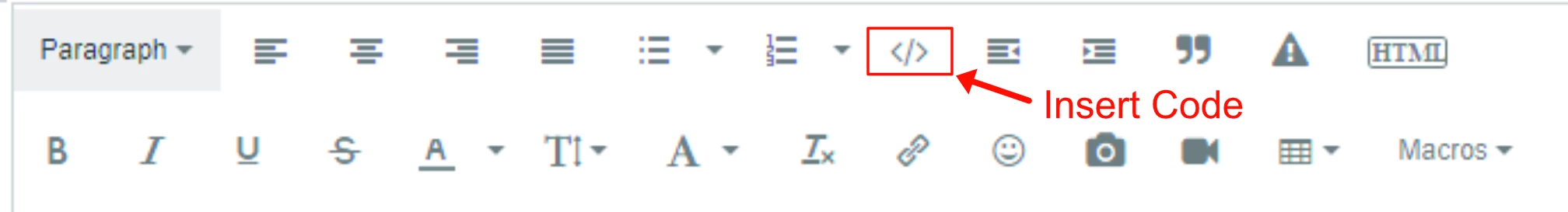

Use the </> when posting code. It properly formats it and so it's easier to view the code instead of all the text left hand adjusted
