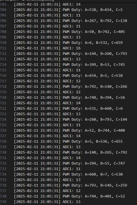

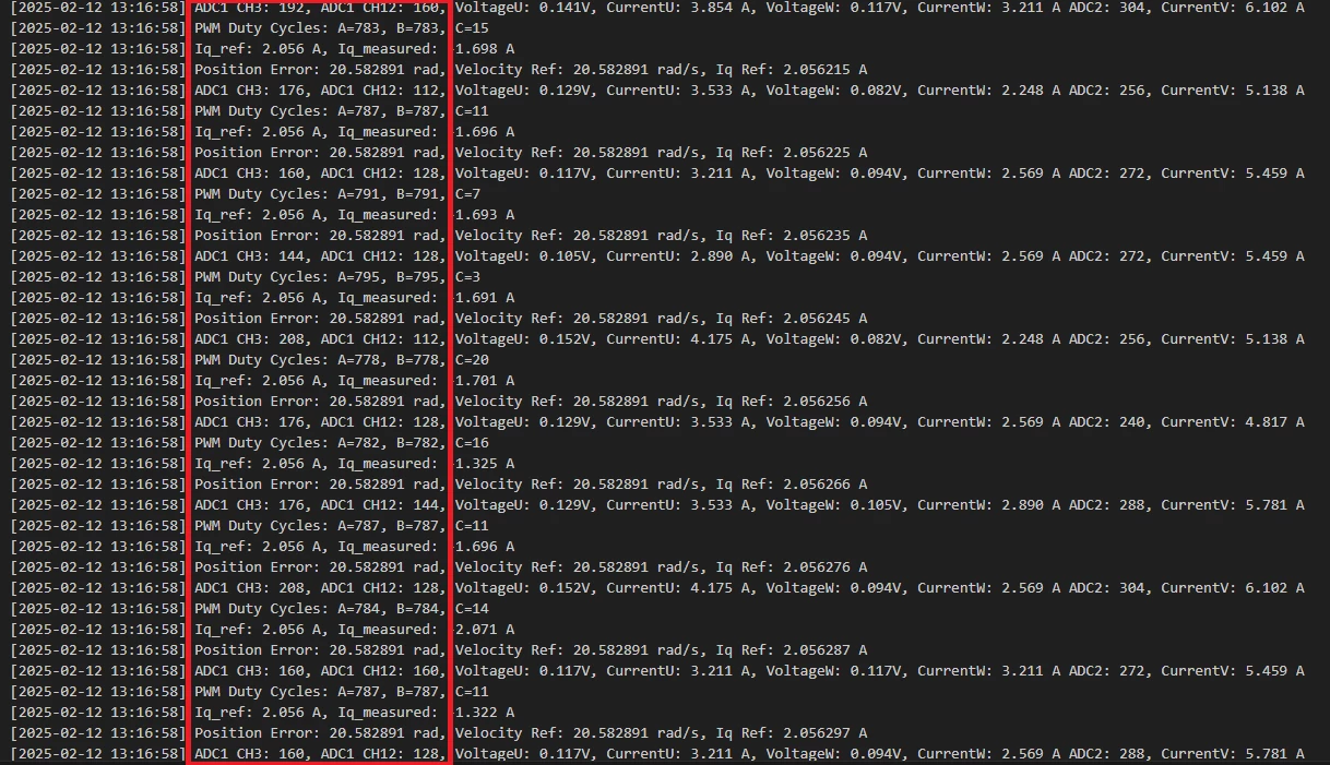

I would like to ask regarding ADC raw value for current sensing in STSPIN32G4. As we can see on below image the raw value of ADC1 CH3 and ADC2 CH12 is always in range of few hundreds. FYI, the motor is in rotating mode. We can see from the PWM duty cycles, it is changing every time.
When measured using multimeter for phase current W, the current is always alternate from +3.5A to -1.2A which make sense. but the ADC raw values keep in hundreds. I was expecting it alternate from > 2048and < 2048.
ADC resolution is 2^12.
2048 = 0A // >2048 = +A //2048 = -A
But the ADC readout values are always less than 2048, or more specifically, they fluctuate between 172 and 208.

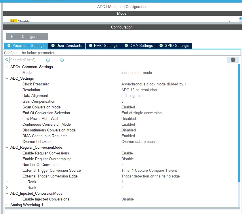

Can you help to advise on this weird raw ADC values? below is my multi-channel ADC1 settings.
We have also tried changing the ADC alignment to right-aligned, but instead, the values dropped to only two digits.
We have attached our ADC.c file. Could you kindly point us in the right direction?

Hello @Sheng123,
ADC full scale dynamic will depend on Rshunt/Gain/Current values as shown in MC Workbench / Current sensing tab (EVSPIN32G4 board):
If you agree with the answer, please accept it by clicking on 'Best answer'.Best regards.GMA
