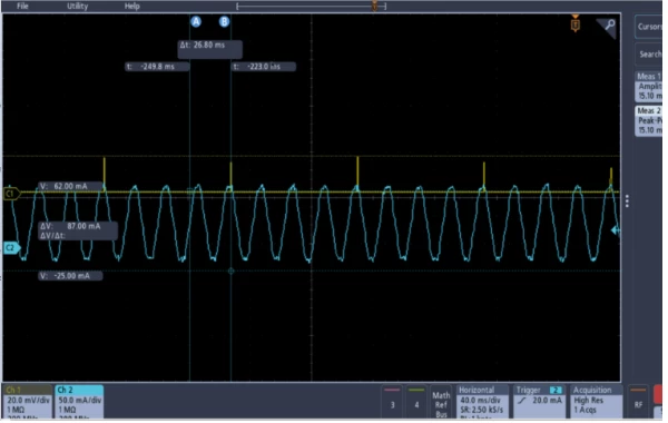

Initially i believed the issue came from the encoder alignment but i could be wrong. To get this value we run the motor in PLL and observed the U current with a current probe and the Z axis of the encoder connected.

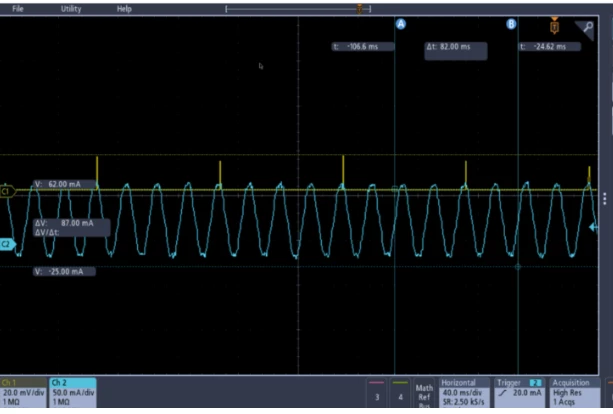

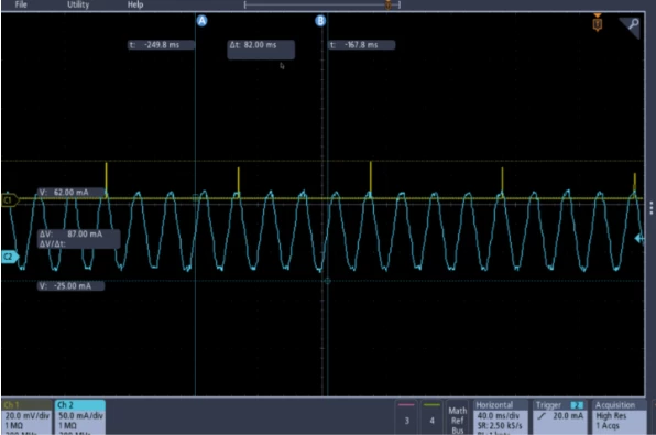

The screenshots above show how i ended up with an encoder alignment of 117Deg (360 = 82ms; 117 = 26.8ms).
And this encoder alignment is what i had used for the testing i described above, But i'm not 100% sure i interpreted the alignment properly because within the same current graph, i can get different data from what i described above

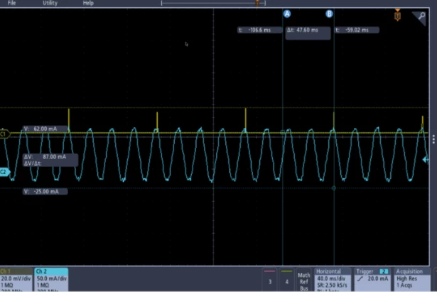

From the screenshot above, i moved the cursors to a slighly different starting point and got an encoder alignmnet of 208 ( 360 = 82, 208 = 47.6)
Could you please clarify maybe by marking how best to categorize alignment in the scope window as shown above?
