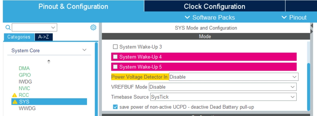

Hi @Shane Kent​,
Thank you for reporting this issue in the code generation process.
To overcome this limitation you may follow these steps:
  1. after generating the code via ST MC Workbench opens the project (IOC file) using STM32CubeMX.
  2. In the "Pinout & Configuration" tab disable the dead-battery function of the UCPD using the checkbox "save power of non-active UCPD". 0693W00000UoBhBQAV.png
  3. Generate the code within STM32CubeMX
Let me know if these info help you to solve your issue.
