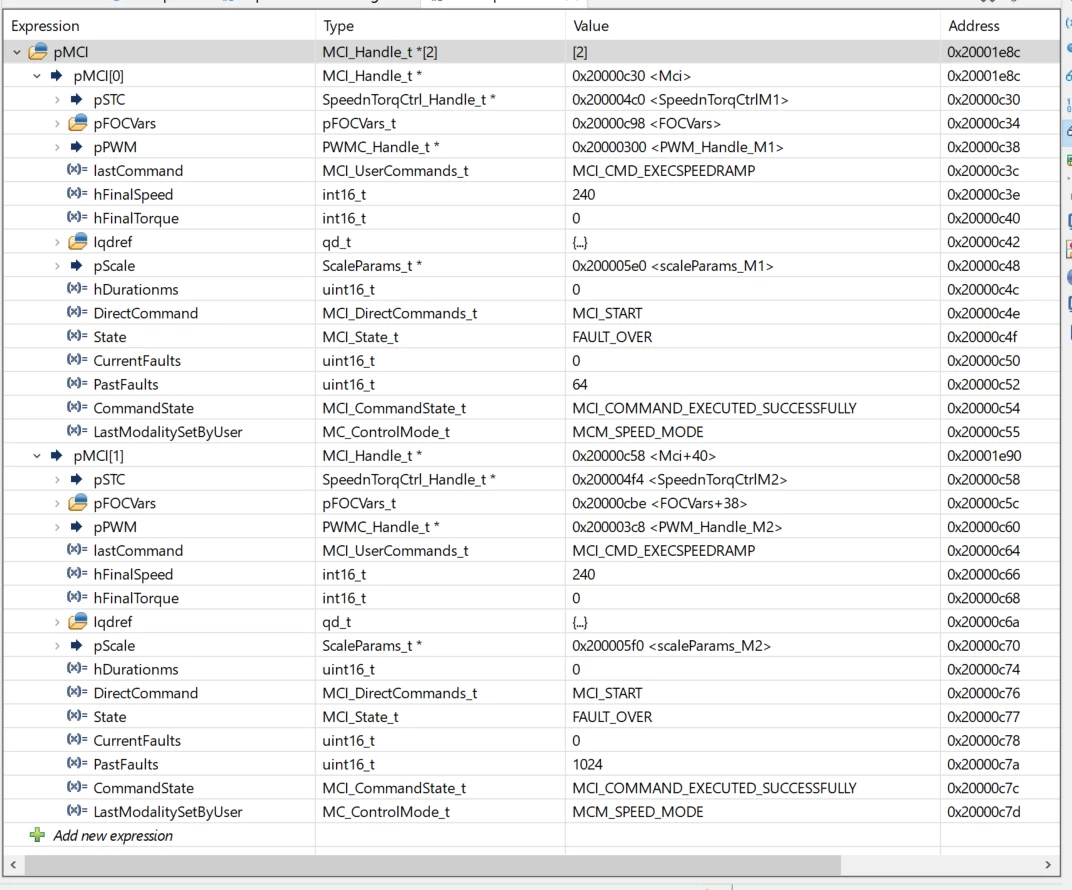

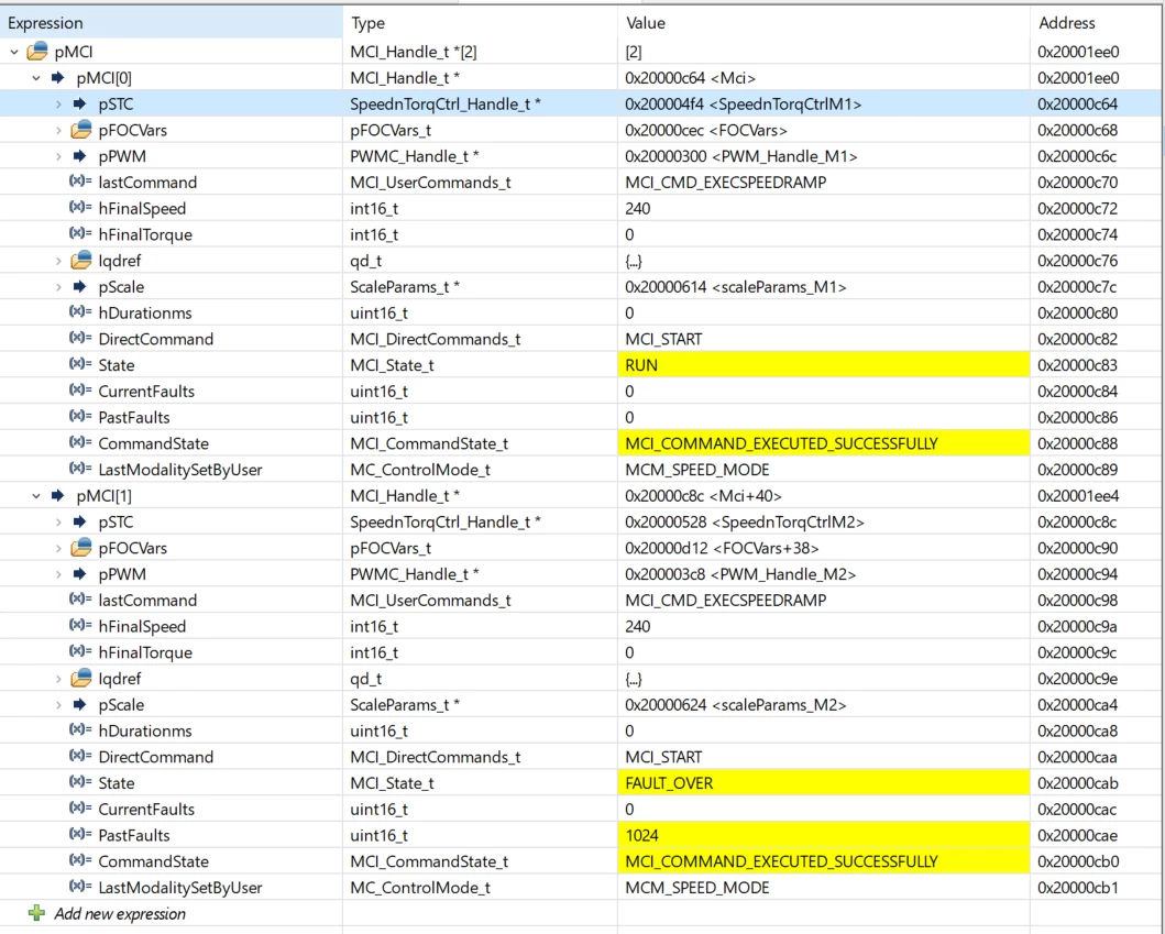

February 9, 2024
hey,
sorry for the delay,
i just tested the project i just call
mc_startMotor1 ()
then i call
mc_startMotor2 ()
just one of them turn
this is a screenShot of the handler of the 2 motors
as you can see the state of the first motor is RUN, and the other is FAULT_OVER
with pastFaults code 1024 and some times both dont start
edit : i found out that theose error linked to dirver protecttion and overcurrent
i fixed them , now i am getting the FOC duration Fault, with the same problem one motor turn the other try to run for a second , then one of them just stop with FOC duration Fault.
thank you in advance.
