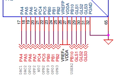

    Hi GMA,
    I have attached the code for the STM32H573 eval board.
    I use the EVSPIN32G4 eval board to control the motor with an analog voltage through the PA4 pin, corresponding to ADC2 channel 17. Despite enabling ADC2 IN17 in CubeMX, the generated code does not include initialization for ADC2 channel 17.

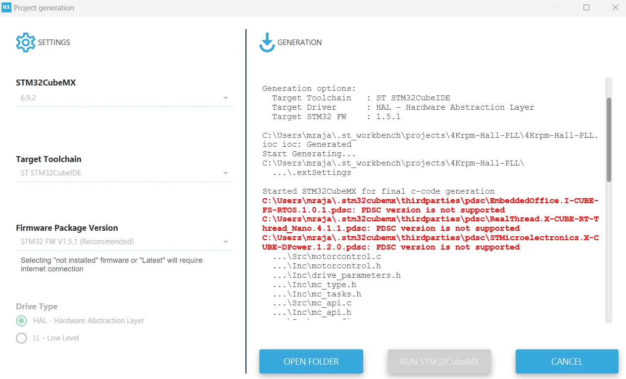

    The Motor Control Workbench project was developed using STM32CubeMX version 6.9.2 and MCSDK version 6.2.0. However, attempting to migrate to MCSDK version 6.3.0 results in encountered errors.
    attr not supported : dmpu
    I have reverted to the original version developed with MCSDK 6.2.0 and STM32CubeMX 6.9.2. However, I am now facing errors with this version as well.

    GMA
    July 12, 2024
    Hello @Mathan Raja,
    Did you add ADC2 IN17 conversion as below? And generating project with CubeMx, did a warning message is displayed?
