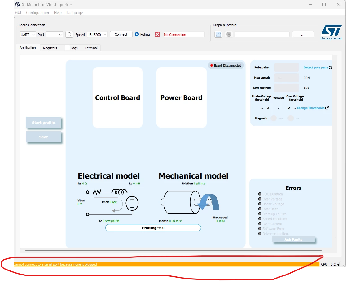

Oct 16, 2025 8:59 AM UTC
Thanks for the documentation details.
I have another question related to motor profiler.
As per the user guide, its saying that motor profiler will open either through workbench icon or from motor profiler option in motor pilot GUI. When I am trying to open the profiler through Pilot, i am getting below error message.
Please guide me what i should do now?
GMA
Oct 16, 2025 9:09 AM UTC
Hello @Sanchari,
You have to select a Port (Motor Profiler tool connection interface part of Motor Profiler documentation or you can use Pilot Discover Board button)
If you agree with the answer, please accept it by clicking on 'Best answer'.Best regards.GMA
