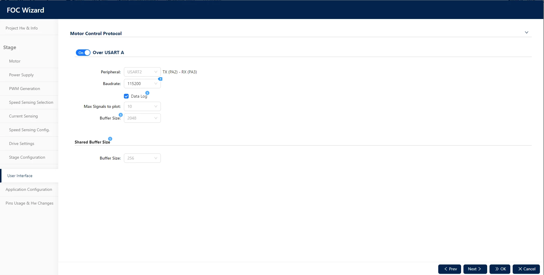

Hi Francesco,
We received the new eval kit and followed your recommendations: we connected it via ST-Link using a USB isolator and powered the board logic with the onboard 3.3V supply by shorting pins 1 and 2 of J8, but the AC is powered from wall socket 240V.
However, we’re facing an issue—when the motor starts spinning after "Start" button is pressed in Motor Pilot, the VCP disconnects from Motor Pilot. The motor continues to run(tuning required), which suggests the MCU is still operating, so it appears to be only a communication/port disconnection problem.
Similar issue I found in this forum (Motor pilot disconnection) , but the recommended fix doesn't seem to work
Do you have a suggestion for fixing this ?
Thanks in advance.
Sujay
Apr 24, 2026 7:29 AM UTC
Hello Sujay,
The first step is to try to decrease the speed of the UART communication.
In the motor control workbench you can find a section "User interface", where you can modify the speed
Cables length matters, you should keep the cable as short as possible both USB and STlink connector. Also that the motor cable should be kept short and far from communication.
Consider also that the board has no EMI filter, because it strongly depends on the motor attached, Adding an EMI filter could help to reduce noise and improve robustness of the communication.
Francesco
sujay-sAuthor
Apr 27, 2026 6:14 AM UTC
Hi Francesco,
Thank you for your suggestions. We’ve resolved the Motor Pilot disconnection issue by using a 2-channel digital isolator between the EVAL kit and the USB-to-TTL converter. I’m now working on tuning the control parameters for the rev-up phase.
