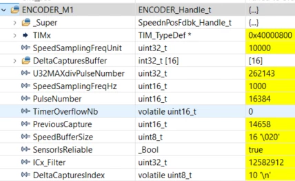

I have not been able to get the Motor Pilot to work for plotting signals.  I can get the Motor Profiler to work but but not the other part of the tool that connects to the motor and you can give commands.  V1.2.9 of Motor Pilot.
I tried reversing the motor phases, and then reversing the encoder phases, which resulted in the same behavior as above:  one connections of encoder wires makes the motor vibrate in place and the other connection can sometimes make the motor rotate for a bit.
But when the motor rotates it does so with inconsistent speed and the torque is very weak.  1/3 times the motor will make it a full rotation when using the encoder mode.  Then where it stops I cannot get the motor to spin again until I move the motor manually by a few degrees, then the motor will spin again weakly as described above.  All of this functional testing is by pressing the SW1 button on the dev kit.

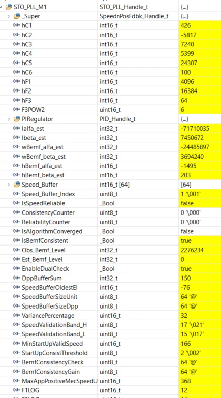

Can you point me towards some variables to check?  It looks like STO_PLL_M1 is the struct to monitor the PLL and ENCODER_M1 is the struct to monitor the encoder.  Is there a way to switch the firmware from using the encoder to the PLL while the program is running?
Is there anything obvious in the encoder struct below that might need to be changed?
For the PLL struct I see the "is speed reliable" bit being flipped when the motor stops rotating
It's weird the motor will spin a little bit sometimes and weakly.  I would expect no rotation and more consistent torque.
