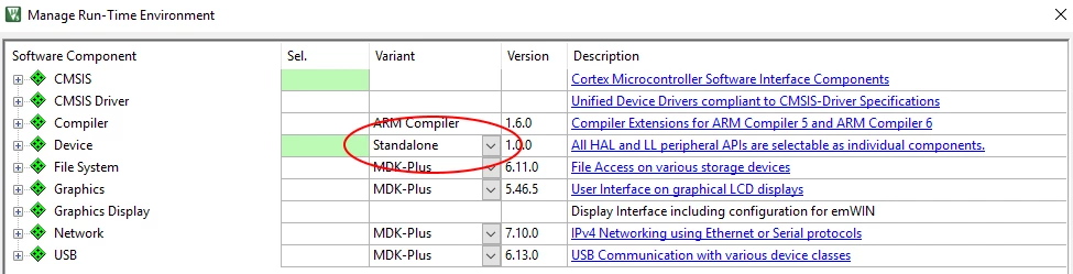

Hi
I am using stspin 3202 six step library to run the bldc motor and using steval3203 board and I am facing this error:
.\Objects\Project_Potentiometer.sct(7): error: L6236E: No section matches selector - no section to be FIRST/LAST.

Hello @Ryada.1​ ,
are you using Keil IDE?
If yes, you have to set the device as "Standalone" in the Run-Time Enviroment (Project->Manage->Run-time Environment) as shown below:
 0693W0000058yftQAA.pngLet me know if you solved the issue, if yes please "select as Best" my answer.
"If you feel a post has answered your question, please click ""Accept as Solution"""
Ryada.1
Ryada.1Author
Oct 24, 2020 5:37 AM UTC
Thanks sir for replay yes i am using keil
Ryada.1
Ryada.1Author
Oct 24, 2020 5:43 AM UTC
i did as same you suggested but problem still remain same

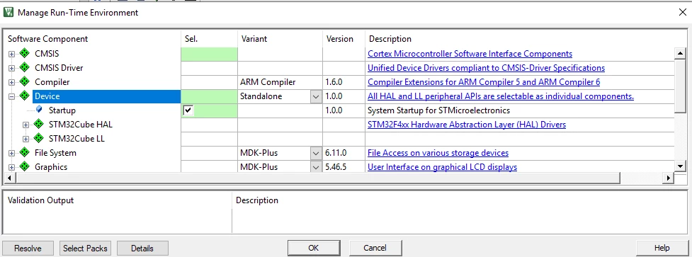

Cristiana SCARAMEL
Oct 26, 2020 3:28 PM UTC
Hello @Ryada.1​ ,
in addition to set the device as "Standalone" in the Run-Time Environment, verify that the "StartUp" option is checked inside "Device".
0693W0000059Ly1QAE.pngThen press Ok in the window and Build the project.
Let me know if this time we fix the error ;)
Ryada.1
Ryada.1Author
Oct 29, 2020 6:51 AM UTC
thanks for reply sir problem solved thanks a lot sir
