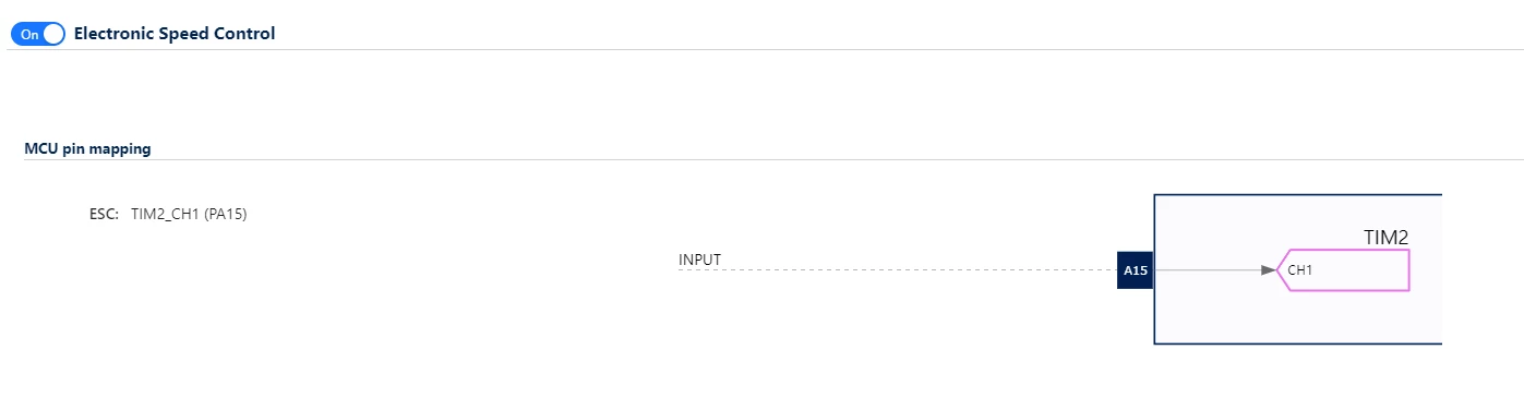

When compiling a test app for the B-G431B-ESC1 board, I generated code using the MC Workbench and cube MX for a 6-step control of a BLDC.
If while in the Workbench, I choose to enable the "Electronic Speed Control" option, I get the error below when compiling inside the ST IDE:
C:/Users/pjreb/.st_workbench/projects/test_4_6s/MCSDK_v6.3.2-Full/MotorControl/MCSDK/MCLib/Any/Src/esc.c:293: multiple definition of `TIM2_IRQHandler'; ./Application/User/stm32g4xx_mc_it.o:C:/Users/pjreb/.st_workbench/projects/test_4_6s/Src/stm32g4xx_mc_it.c:103: first defined here
How can I fix this?

Selecting another timer than TIM2 (used by ESC) on Workbench Speed Sensing Config should work

I changed to TIM3 and it compiled without errors.
However, now I can't get the motor to run. It wiggles back and forth and mostly doesn't respond to commands.
I also noticed this:
Shouldn't be updated to TIM3 ?
