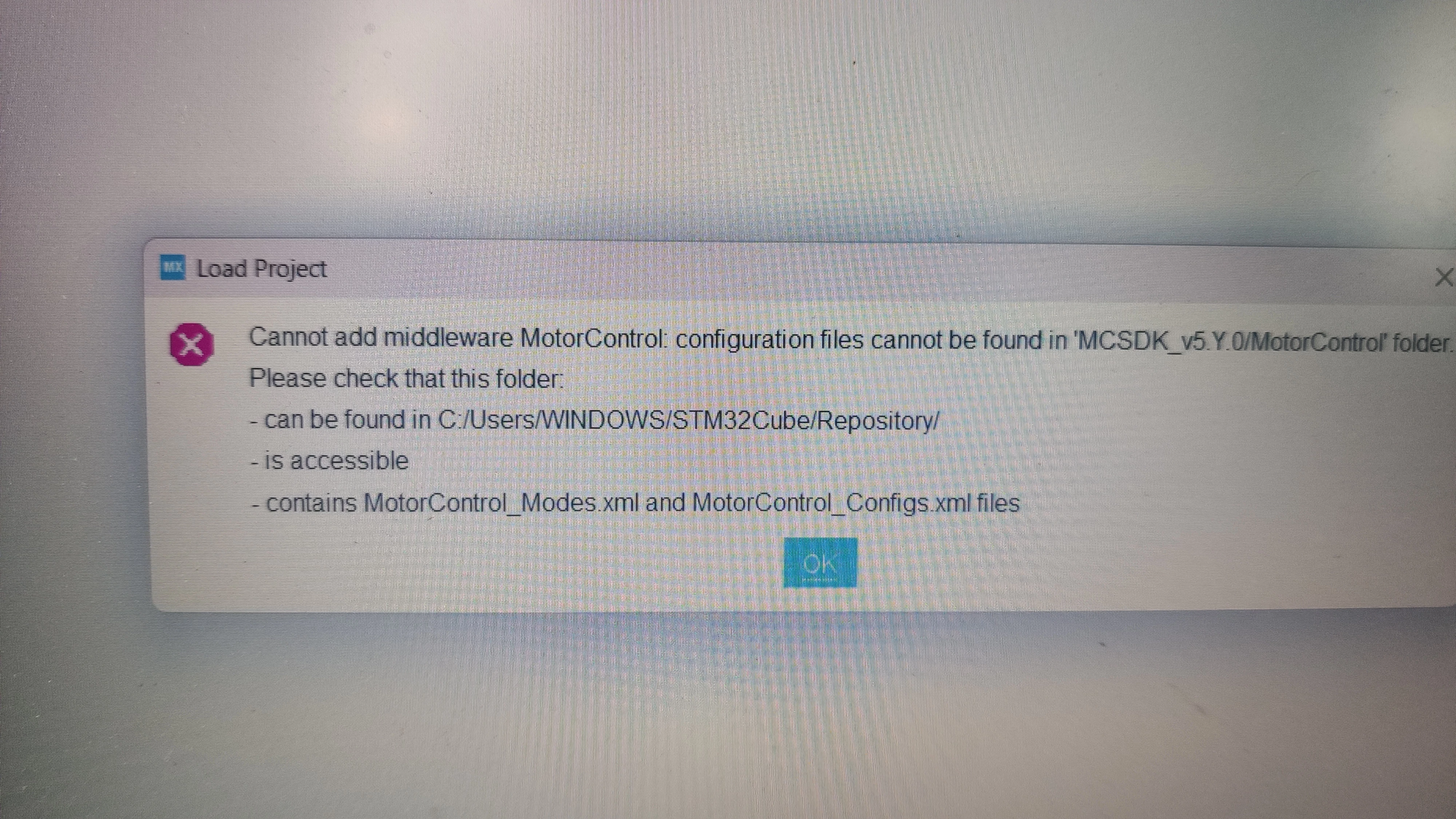

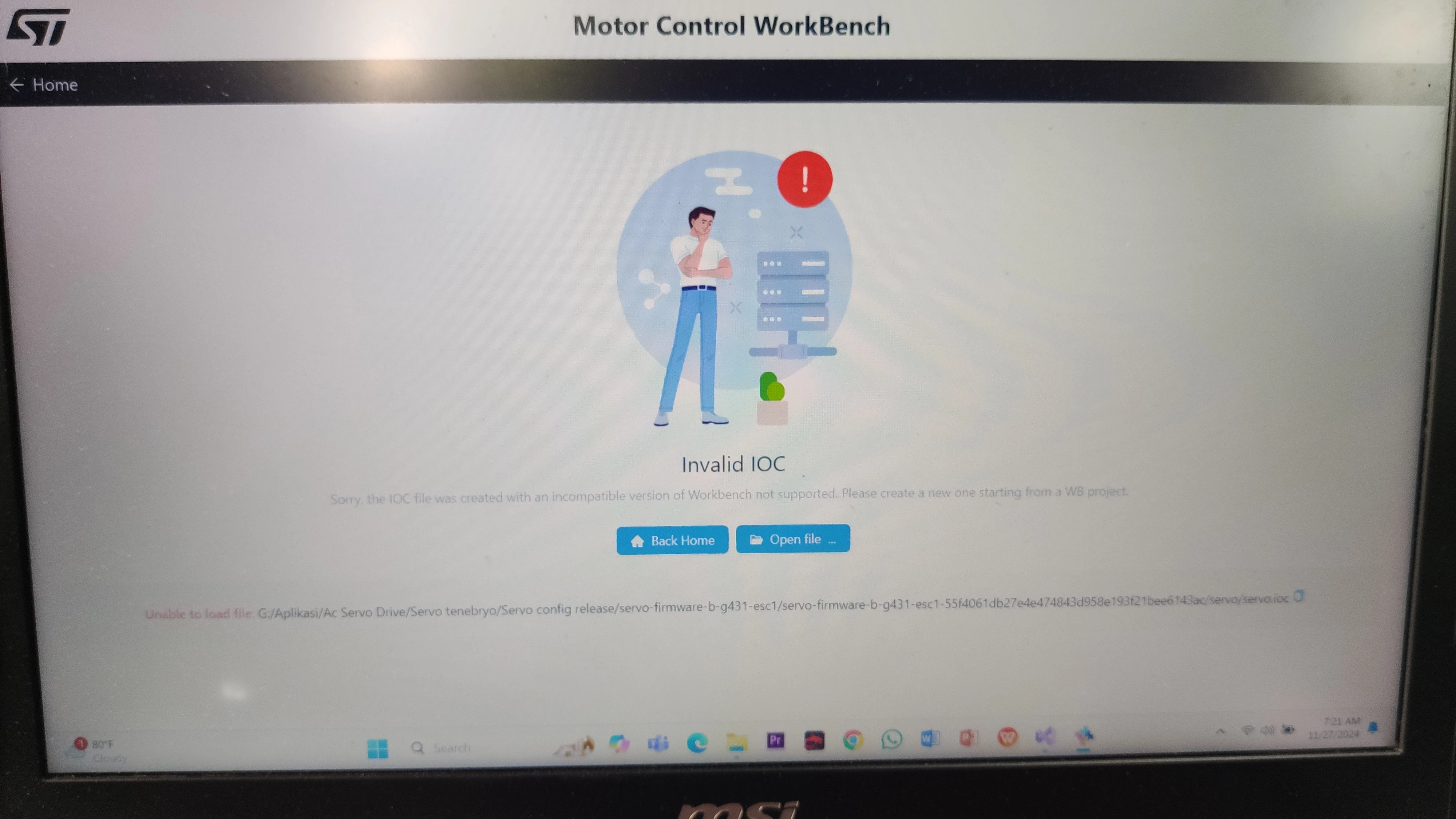

Good day all,
I was found project on github, and interest to learn about it, but that projec was made by MC SDK 5.y.0 but i see no more aviable that version only 5.4 and 6. When i open it by version 6 they say ioc is infalid. So what sould i do?? Any one know how to migrate code mcsdk 5.y.0 to version 6???
Also error when i open with with cubeMX version 6.
Thank u all:folded_hands:

Hello @Arta-Botak,
a project built using MCSDK v5.y.0 is not compatible with the MCSDK 6.x, there is no automatic conversion possible, you should create a new project taking into account the settings from you original IOC.
Thanks for your comprehension.
Regards

So it need to put user code to new mcsdk code?
