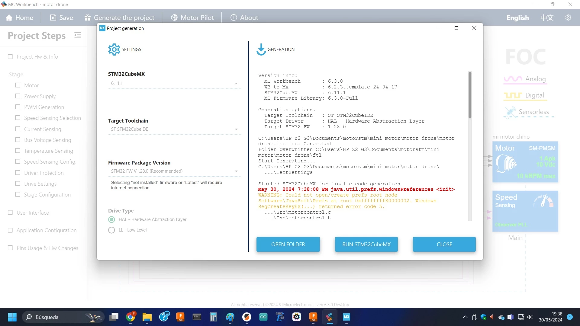

Hello, I am using the MotorControl Workbench_6.3.0 tool.
and it gives me an error when generating the project.
In the end it tells me completed with errors.
What is happening wrong?
Thank you very much for your time.

Hello OttoBCN,
This is a strange error, we will try to investigate it, but this has probably to do with your CubeMx installation. However, when you scroll down the generation log, if the main.c file has been generated, then there is a high chance that your project has been correctly and entirely generated, so I advise you to firstly ignore that error and see if your project compiles and your motor runs.
In any case, if you could send your CubeMx log file that would be great. You can find it under : C:\Users\username\.stm32cubemx\STM32CubeMX.log

Thanks for your quick response.
I have tested the generated code and it is correct, it works with the generated code.
I am sending you the file that you requested (STM32CubeMX.log).
