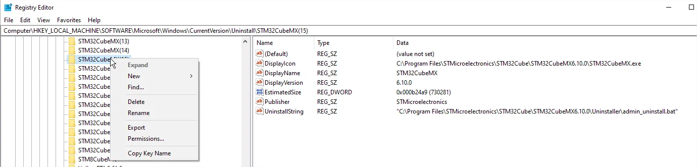

error in MX generating from MC workbench
Please I need a help, I'm using the MC workbench and after saving the project and reach to generate the project it's giving this error that the MX is not found or I need to install a verison more the 6.0. bytheway I already installed the latest version but the problem is not solved.
Please if it's possible to provide me with any feedback how it's possible to solve this issue.

It could happen if one version of CubeMX has been install several times at different locations.
Could you please, uninstall your CubeMx 6.0 Tool version(s) and launch "Registry Editor", and check if in HKEY_LOCAL_MACHINE or HKEY_CURRENT_USER tab, in following path:
Computer\HKEY_xxx\SOFTWARE\Microsoft\Windows\CurrentVersion\Uninstall
that there is no remaining key corresponding to CubeMx 6.0 (DisplayVersion field) version in your case.
If yes, please delete it and install CubeMx once again.
