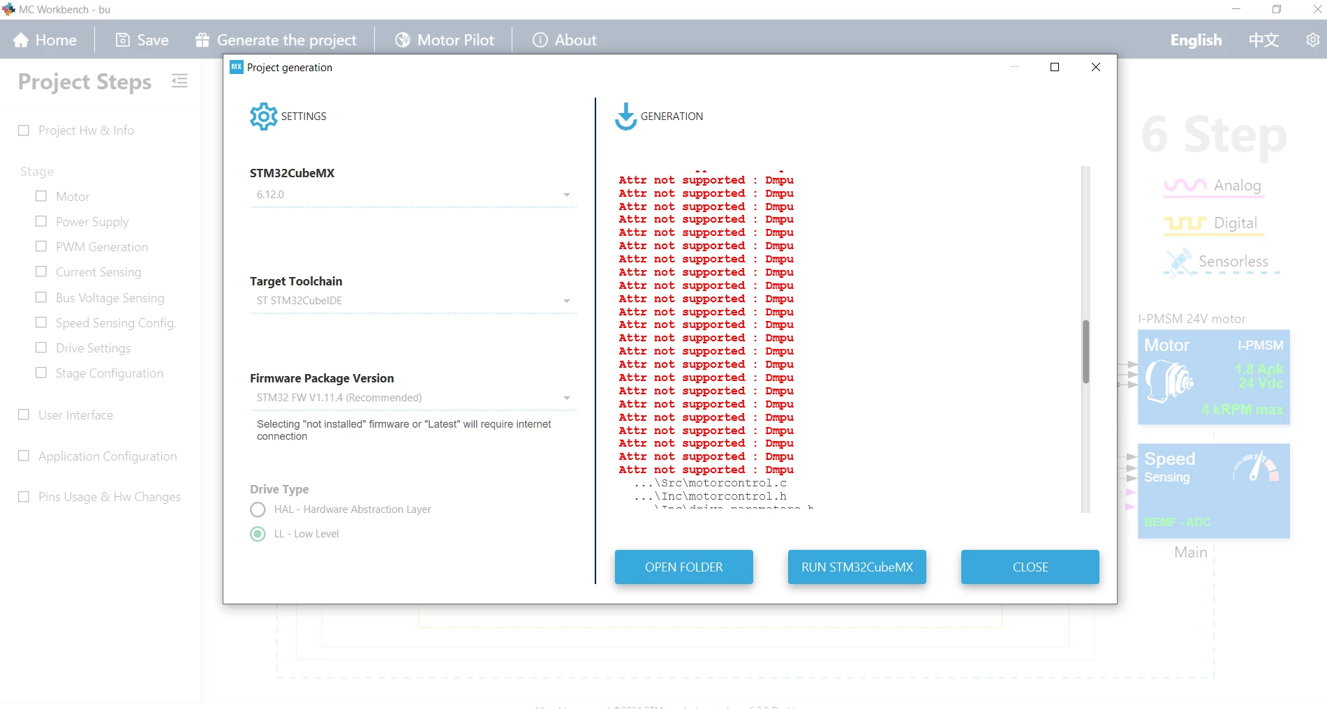

Error Attr not supported: Dmpu while generating code for STEVAL-SPIN3204 from motor work bench
Hello Team,
   we are using  STEVAL-SPIN3204 board to run our BLDC motor. As per guidance given STM32 motor control software we are getting error while generating code , below is snapshot for same. we have install all latest version of STM cube IDE,motor control work bench and STM cube MX. please guide us how to solve below problem.
due to below error the code is not generated.

Hello @sshin.9,
As mentioned in this post, it is a known issue. Please, ignore error message and proceed with the generated project.
If you agree with the answer, please accept it by clicking on 'Best answer'.Best regards.GMA
