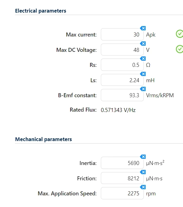

In MC Workbench, I have set the following:
I have configured the quadrature encoder to 2000 pulses per mechanical revolution.

  1. Which parameter in MC Workbench should be set to 250 rpm? The ‘Target speed’ in the Speed Regulator?

SUSPECT no.3: are the motor parameters correct? “It’s good to trust the datasheet, but better not to” – so I’ve decided to estimate them using your Motor Profiler (thereby switching to sensorless control). Here too, I’m not quite sure what values to set for ‘Max Speed’ and ‘Max Current’ for the estimation… the motor’s maximum values? Or the maximum values I set on the bench-top power supply? This test leads to another problem:
PROBLEM no.2: at around 28%, the profiler ‘freezes’ – that is, the motor accelerates for a few seconds, then stops abruptly, then starts turning again for a few seconds, then stops abruptly, and so on, until it triggers an overheating fault. I’ve tried both the motor’s rated current (minus 15%) … and 5A (well below the motor’s 50Apk) … but the problem persists.

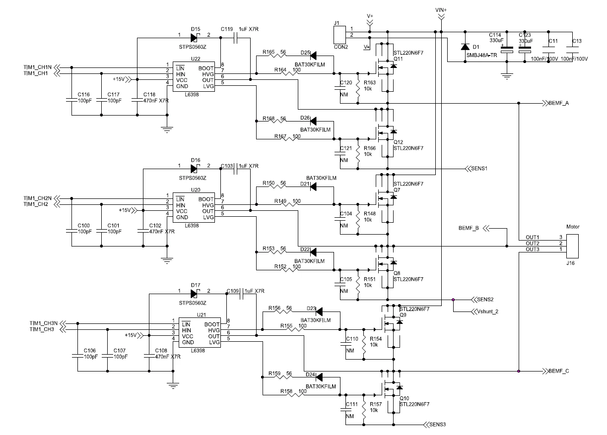

I don’t think the connections are wrong. This is what I’ve done – please let me know if I’ve made any mistakes:
  1. In the stm32g4-nucleo schematic:
Ch U: PA8 (pin 42, D7)
Ch V: PA9 (pin 43, D8)
Ch W: PA10 (pin 44, D2)
  1. In the IHM-08M1 schematic:
OUT 1: PhA à TIM1_CH1 which corresponds to PA8 (as seen in the microcontroller reference manual)
OUT 2: PhB à TIM1_CH2 which corresponds to PA9 (as seen in the microcontroller reference manual)
OUT 3: PhC à TIM1_CH3 chewhich corresponds to PA10 (as seen in the microcontroller reference manual)
  1. In my motor’s datasheet:
Ph U: blue wire
Ph V: brown wire
Ph W: pink wire
As for the encoder, on the IHM08M1 the PCB clearly shows where A, B and Z go … so I connected the encoder’s A, B and Z pins
