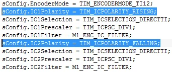

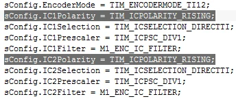

AntoineC
Dec 19, 2019 8:09 AM UTC
With the checkbox "reverse counting direction" you can reverse the signals wires of the encoder.
The corresponding code :
  • Reversed
  • Not reversed
You can find more details in the reference manual of your STM32. Have a look to the 'TIMx_CCER' register and 'Encoder Interface Mode'.
Antoine

AntoineC
Dec 20, 2019 9:05 AM UTC
In fact, yes, "#define ENC_INVERT_SPEED" is not used in the generated code. The checkbox in the WB make differences in the main .c. It changes polarity like the pictures I sent you in my previous answer and you can use the polarity to make the inversion enabled.
Antoine
