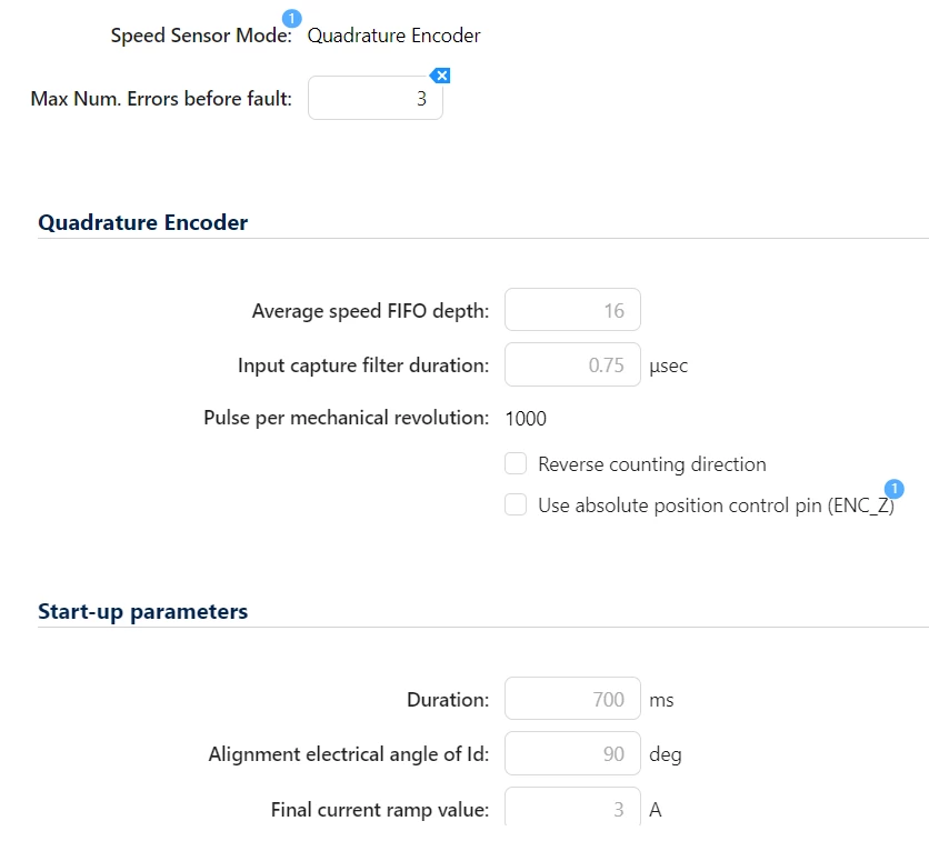

My main sensor is SE461000AB10030 encoder (I do not intend to use a sensorless system) and I’ve set it to 1000 ppr on the MC Workbench. With other commercial inverters, I’ve always used it with only its A, B and Z outputs (not the differential inverted ones)

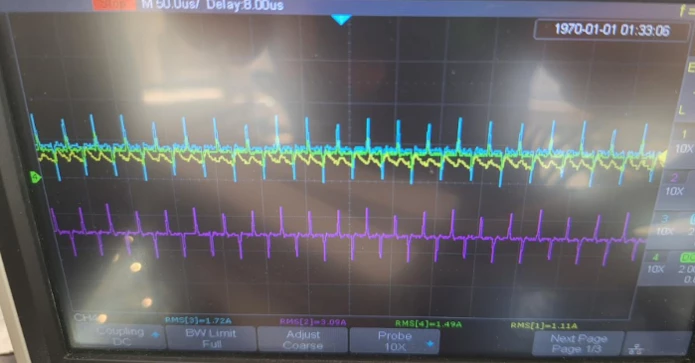

When I power up via usb the evaluation board (DC bus off), I turn the rotor with my hand and connect the oscilloscope to CN7_17 and CN10_31, I can see the encoder pulses correctly; and when I turn the encoder by hand through one mechanical revolution (360 degree), TIM2->CNT goes from 0 to 4000, as it should.
The problem is that as soon as I press START (blue push botton), the rotor gives a brief slow jolt, the state machine switches to “alignment” and finally enters “run” mode without any faults; the currents across the three phases are these         but the rotor is stuck (it isn't moving...)

  • bMaximumSpeedErrorsNumber    = 3
  • TimerOverflowError    = false
  • TimerOverflowNb              = 0
It seems strange to me that bMaximumSpeedErrorsNumber = 3 … and it always happens: as soon as I press the reset button (the black one), it immediately goes back to 3.

Hello ​@luke514,
Verify the motor phase U, V, and W connections.
Set the main speed sensor to sensorless mode and the auxiliary speed sensor to Encoder mode. If the motor spins correctly, verify that the sensorless and Encoder electrical angles are aligned.
