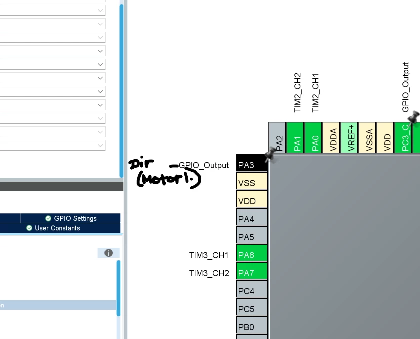

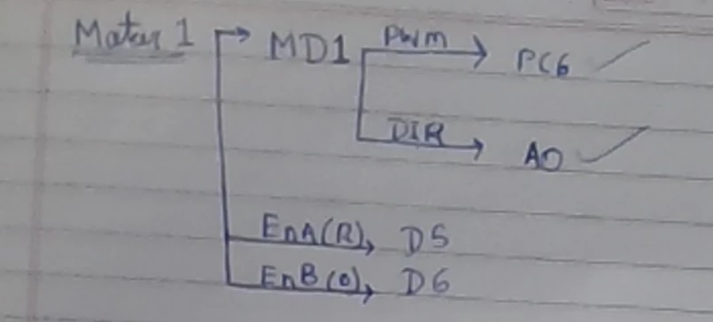

I am testing Rhino encoder motors(ig32) 100rpm on an STM32H723ZG Nucleo-144.
my actual connections are:
Motor driver PWM  → PC6  → TIM8_CH1
Motor driver DIR → A0 → PA3

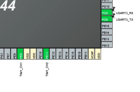

Encoder A → D5 → PE11 → TIM1_CH2
Encoder B → D6 → PE9 → TIM1_CH1
my confirmed the CubeMX configuration shows:
TIM1 Encoder Mode = TI1 + TI2
PE9 = TIM1_CH1
PE11 = TIM1_CH2
So the encoder is a genuine quadrature encoder, and I have intentionally kept TI12 rather than switching permanently to TI1.

13. Current configuration I consider correct
For now, the intended configuration is:
Encoder mode: TI1 + TI2
Polarity: Rising
Encoder A: D5 / PE11 / TIM1_CH2
Encoder B: D6 / PE9 / TIM1_CH1
Motor PWM: PC6 / TIM8_CH1
Motor DIR: PA3
