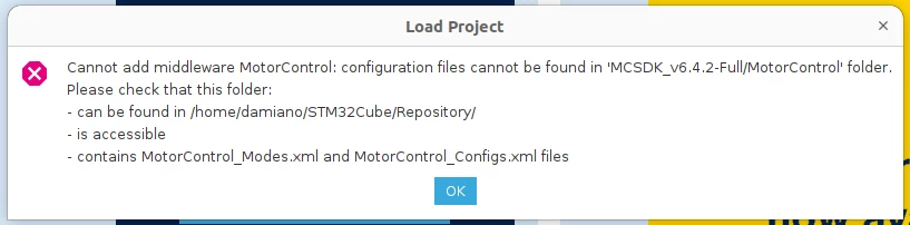

Edit an STM32CubeMX project that uses motor control SDK from linux
I know that Motor control workbench is only available on Windows but I hoped that it would be possible to open the generated .ioc file from Linux. I tried it and I got this error. Can this be fixed or I cannot even open the STM32CubeMx project from linux?

Andrew Neil
Jun 25, 2026 9:15 AM UTC
That message tells you 3 things that it needs.
So did you try providing those 3 things ?
DamianoFAuthor
Jun 25, 2026 12:06 PM UTC
  1. What does it mean that a project folder can be found in another folder inside ~/STM32Cube/Repository?
  2. is accessible? Yes, it does exist and can be accessed by any user/group
  3. It does not contain MotorControl_modes.xml and MotorControl_Configs.xml. But where do I find them?
Thank you for your answer!
Andrew Neil
Andrew NeilBest answer
Jun 25, 2026 1:29 PM UTC
It means that one needs to be a subfolder (ie, subdirectory) of the other; so:
~/STM32Cube/Repository/MCSDK _v6.4.2-Full/MotorControl
You say it works in windows.
So look at your Repository in Windows, and make your Repository on Linux look like that
