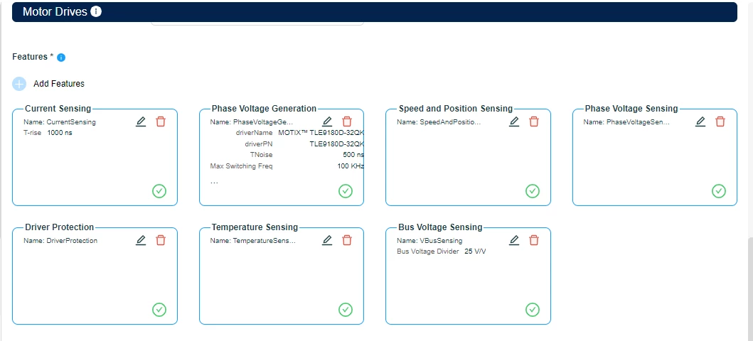

Hi Team,
I'm working on design the custom inverter board for 3 Phase BLDC Motor for rail door application.
Motor driver these feature needed for project
In motor Driver protection this one im using
In Phase voltage generation TIM8 using and the motor driver IC i'm using from Infineon TLE9180D-32QK.VINODC_2-1757074732425.png

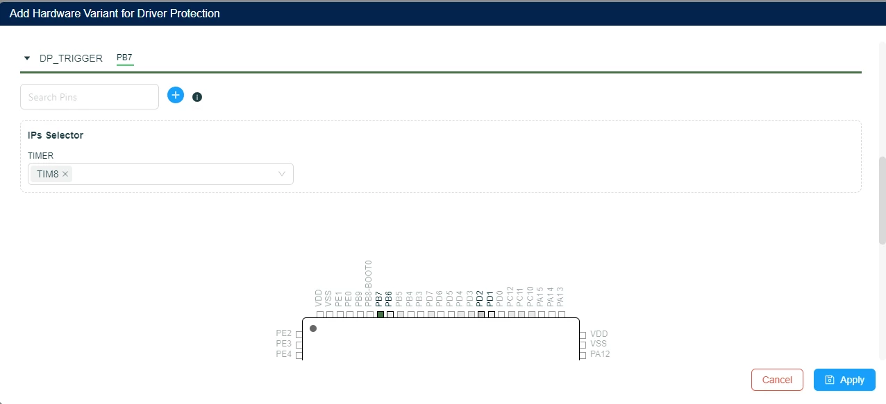

How should i connect this pin to uC to Motor driver IC
and configuration need to done.

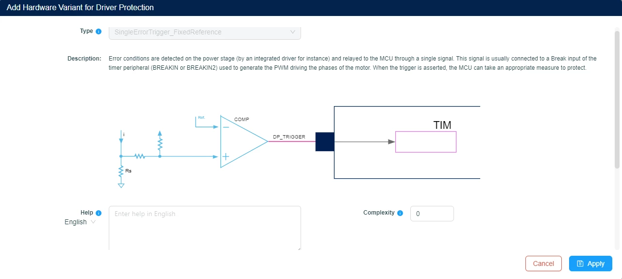

Hello @VINODC,
The driver protection input must correspond to an error detection output from the driver side.
Refer to the driver user manual for details on the error signal presence and its electrical behavior.
