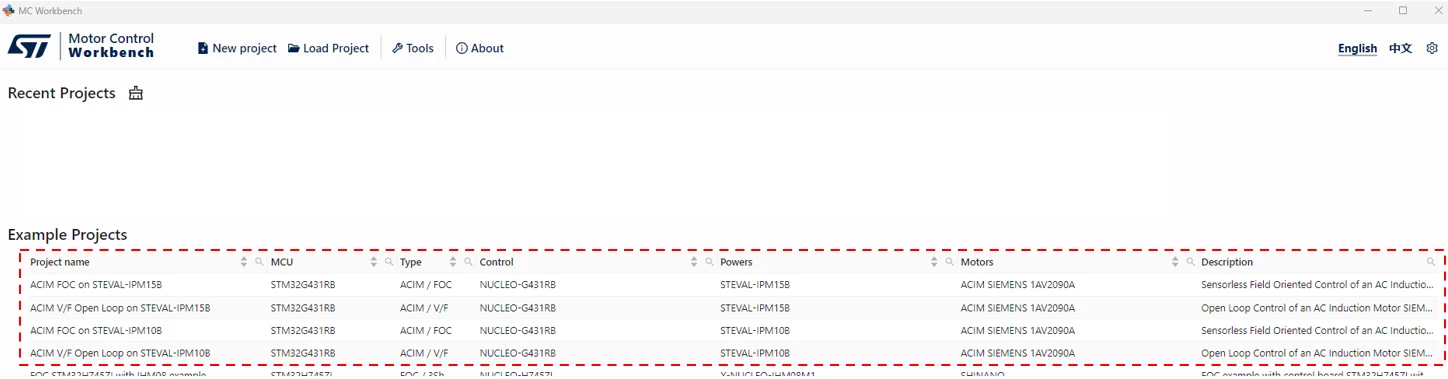

Hello ​@anuragkr,
Four Alternating Current Induction Motor (ACIM) examples are provided in MCSDK 6.4.2 available here, with dedicated documentation.
These examples are based on NUCLEO-G431RB control board.
For quotes and prices, refer to the ST contact page.
