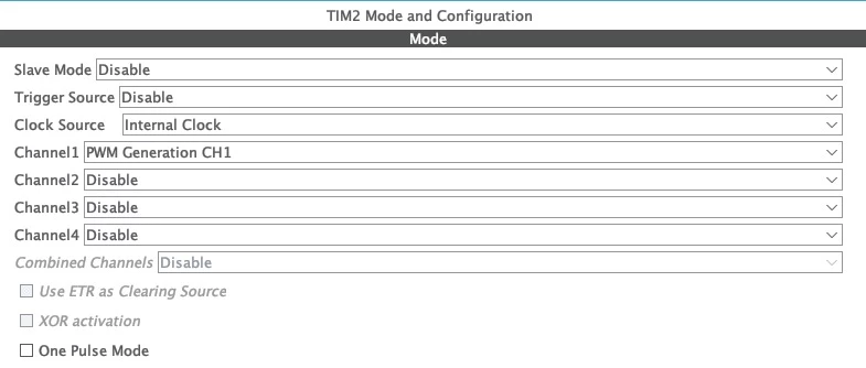

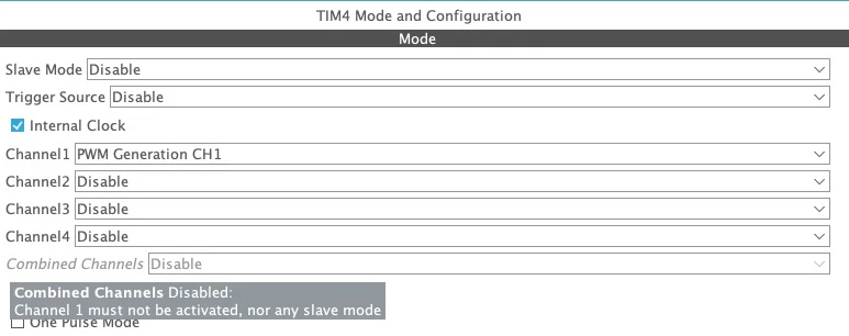

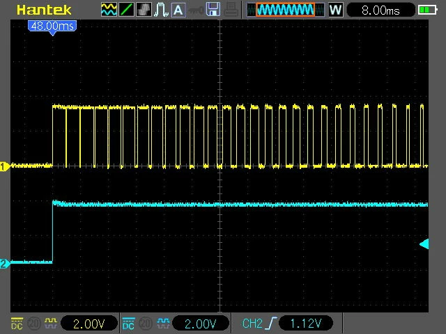

In fact, I can link TIM1 and DMA2, TIM4 and DMA1, but we can't make a link TIM2 DMA1. We try another example : TIM4CH1 and TIM2CH1.
If we use PWM without DMA with HAL_TIM_PWM_Start(&htim2, TIM_CHANNEL_1), it's run OK, so it's not a hard problem.

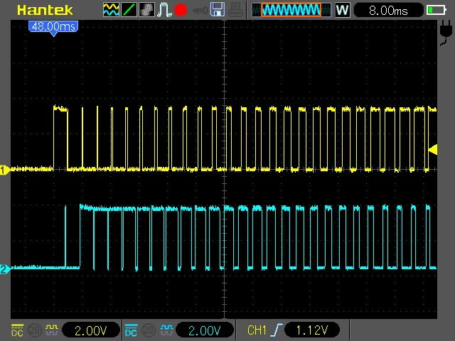

On this pict, the yellow is on TIM4CH1, with DMA1, and the blue signal TIM2CH2 with DMA1
The configuration in Cube MX is the same, and the prorgam is the same.

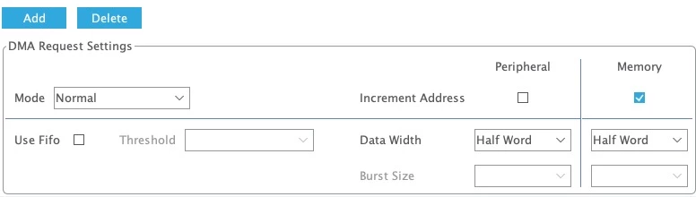

0693W00000aJsNVQA0.jpgand for the 2 DMA the conf are the same :

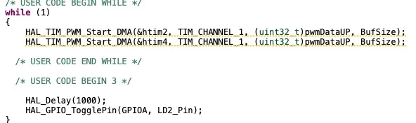

the test prorgam is very simple (pwmDataUp is a 32 * 16 bits data table)

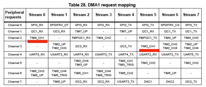

The DMA table in RM0390 page 207 :

>>Is there any difference between TIM1 DMA2 and TIM2 DMA1 ?
Different Buses, and DMA units.
TIM2 is 32-bit wide, don't do 16-bit DMA to it.

The TIM2 is 32 bits, the Tim1 & TIM4 are 16 bits. I always use the F103 where all the timer (1-4) are 16bits.
I jutse change the deep from 16 to 32… and it's run !
0693W00000aJskoQAC.jpgI was also put in error because on many (all ?) tutorial, they choose half word, and (for example) in the link I share in top, the reason is "I am using the data width of half word here, for no particular reason" …
thanks again !
(so now we need to generate tables of 32 bit words, I hope we have enough memory :face_with_tears_of_joy: )
