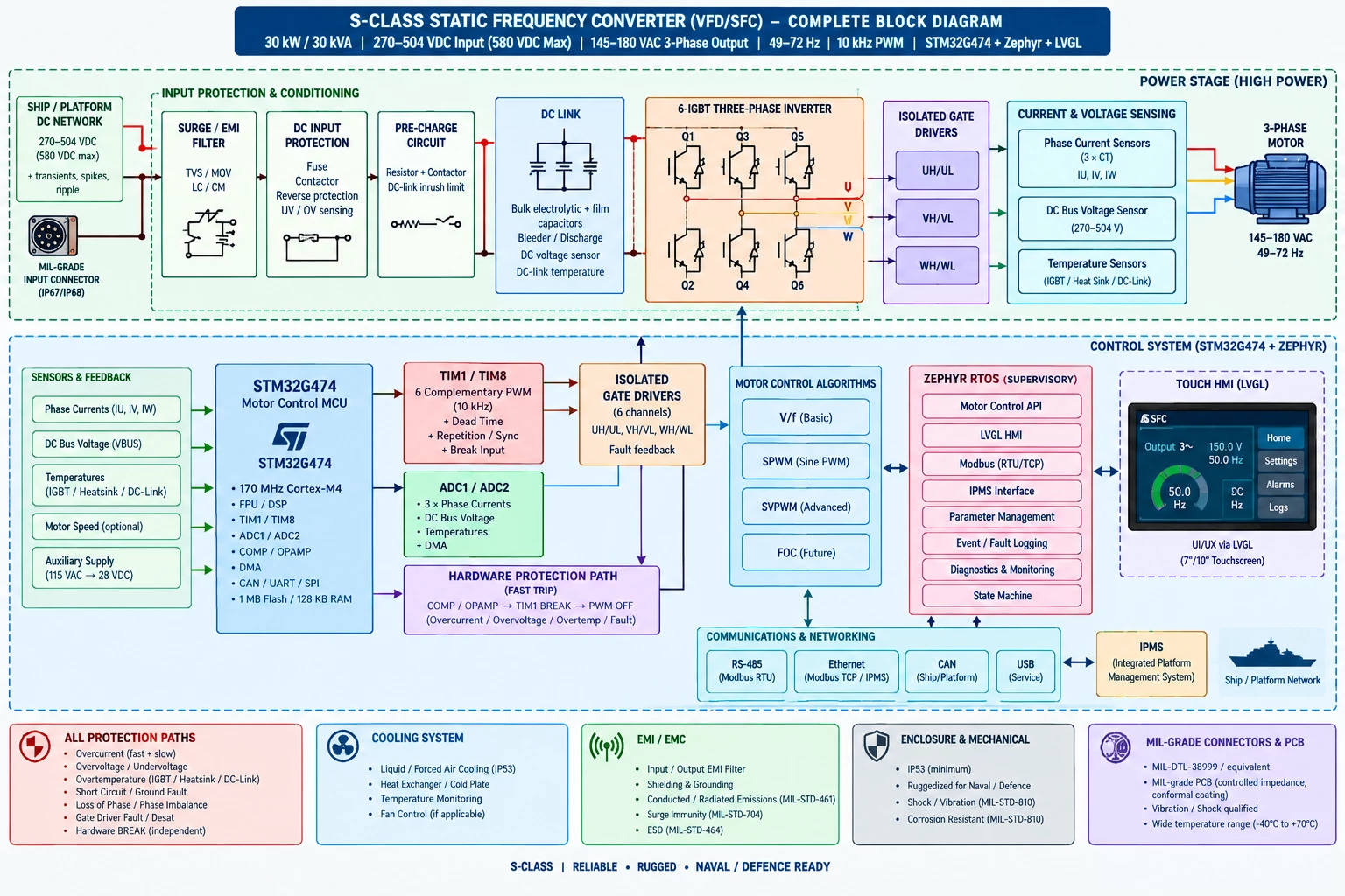

dc vfd in house build
We are planning to built a custom DC VFD in house.pleade refer below block diagram
which devkit is suitable for prototype?
Thanks and Reagrds,
