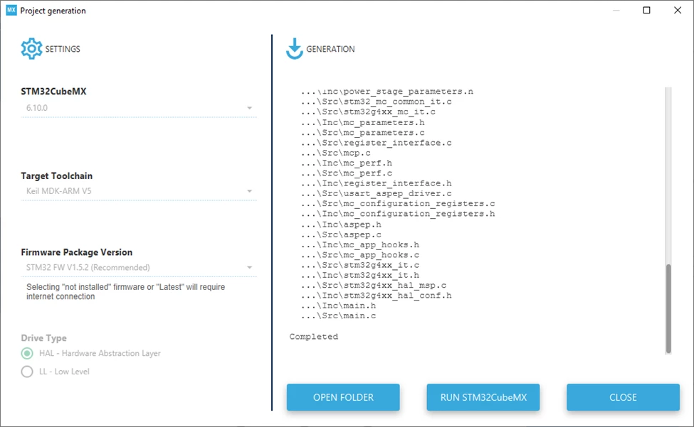

Here is how I generated the code:
MC Workbench 6.3.0, FOC/3 Shunt
STM32CubeMX 6.10.0, STM32Cube FW_G4 V1.5.2
MDK-ARM V5.32
No error in each of these steps of the project and the code generation.
