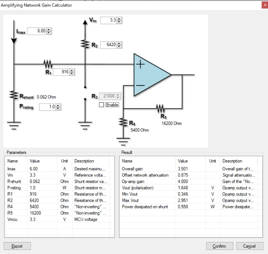

This is my Amplifying Network using internal Op-amp gain of 4x and I just have external resistors R1, and R2. The resistors R4 and R5 are internal as you well know:

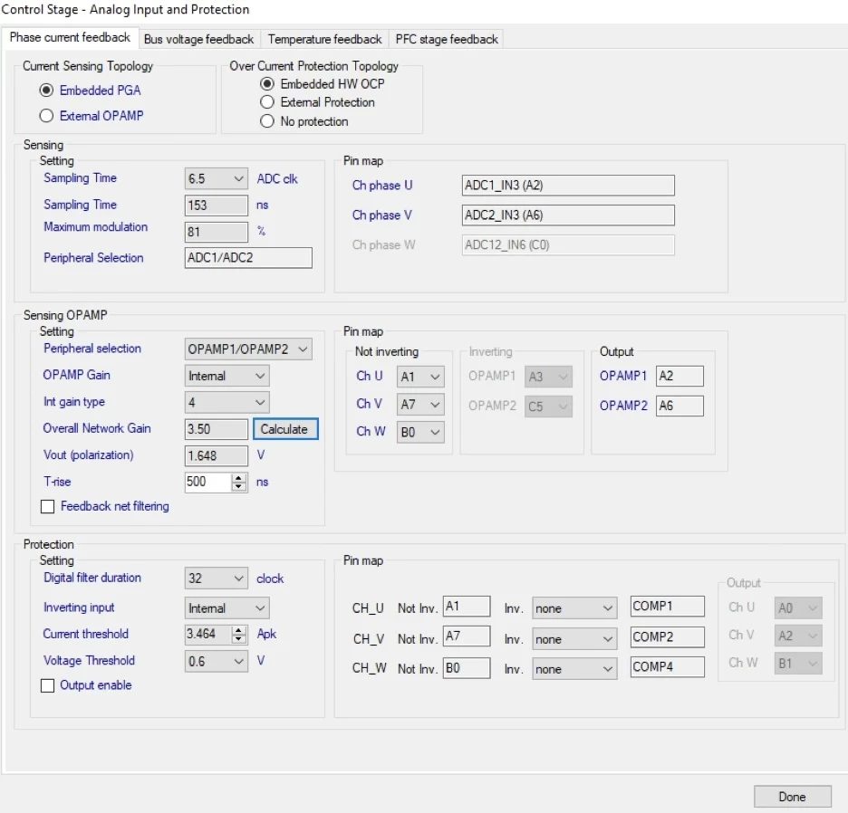

Now I am migrating to MCWB 6.3.2 and am starting configuration from Inverter Board EVLSPIN32G4-ACT as I had done before.
However, in Current Sensing, I noticed that:
1.) Channel W is connected to OPAMP2, but I believe that doesn't change anything since my board has same resistor network for all three op amps and I understand that channel V will be inferred from the two other channels
2.) Internal PGA Gain of 4 (600mV) is not an option, even though this MCU has that as an option and previous firmware allowed that as you can see form the screenshot. Is this just a bug in the system, and can I simply change it manually in the code? I designed our board based on a gain of 4 so I really need that to be the case.
3.) There are no inputs for the external network for gain offset, as I had before as you can see in one of the images above. However, since that is an analog input does that mean that it won't make a difference for the firmware as long as it is between 0 and 3.3V?

2) "Internal PGA Gain of 4" is not available in the original EVLSPIN32G4-ACT board because it will not respect min/max VOUT or polarization offset limits for example.
Modifying EVLSPIN32G4-ACT.json file with your parameters, Internal PGA Gain of 4 is available on MC Workbench.
3) Do you mean "Offset Network Attenuation"? It is still present in EVLSPIN32G4-ACT.json file.
