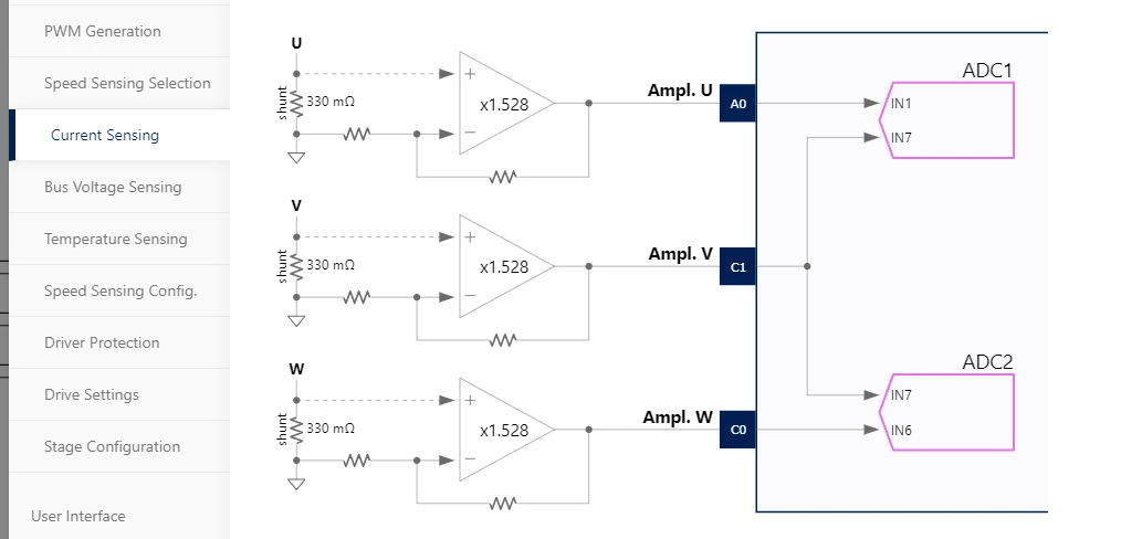

I am working on a custom FOC Inverter Board.  I am trying to assign the pins for current sensing, but I keep getting warnings.  I am using an STM32G431CBT6 MCU, and I completed all the other pin assignments without issue.  Here is the Current Sensing information:
"Three Shunt AmplifiedCurrents using External Op-Amps"
CURRENT_AMPL_U -> Assigned to PB14 ADC1_IN5
CURRENT_AMPL_V -> Assigned to PB12 ADC1_IN11
CURRENT_AMPL_W -> Assigned to PB11 ADC12_IN14
It looks OK in the board designer application with no warnings, but when I try to generate the project in Motor Control Workbench, it gives me the following errors:
I cannot find any documentation on the list of warnings/errors.  How do I correct this?  Or can it be ignored?

Hello @reesed13,
It is mentioned that the shared phase could not be assigned.
For DualADCs, CURRENT_AMPL_V should be shared (in your definition, W is the shared phase):
