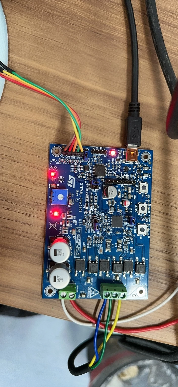

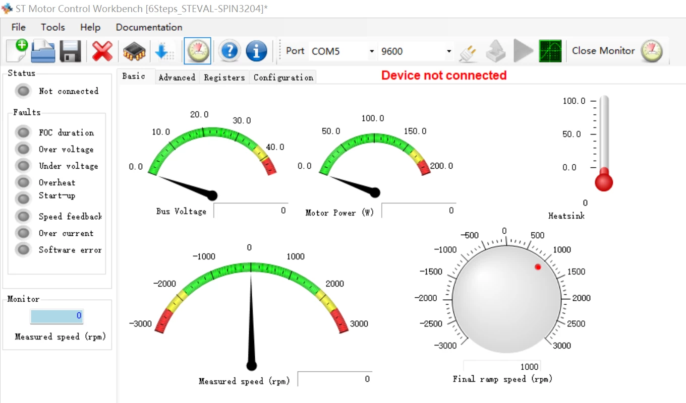

Connection faiLED, No response, check the communication cable, the power on the board or the baudrate (set to 9600 bps)
I did connected the board to PC with USB2.0 cable, and I suuplied 24V DC to the board(STEVAL-SPIN3204) and set the baudrate to 9600 bps, ​ still this problem happens. 0693W00000bh7DBQAY.png0693W00000bh7DLQAY.jpg

I'm using version 5.4.8, and I chose Keil MDK-ARM V5 as the target Toolchain. When I build the project,I also encountered error L6406E but I don't know how to deal with it.
Gael A
March 29, 2023
The L6406E error refers to a lack of space in your target MCU. If you are using a free licence for Keil, maybe there are some limitations about the size of the program.
Have you tried generating the project on CubeIDE ?
