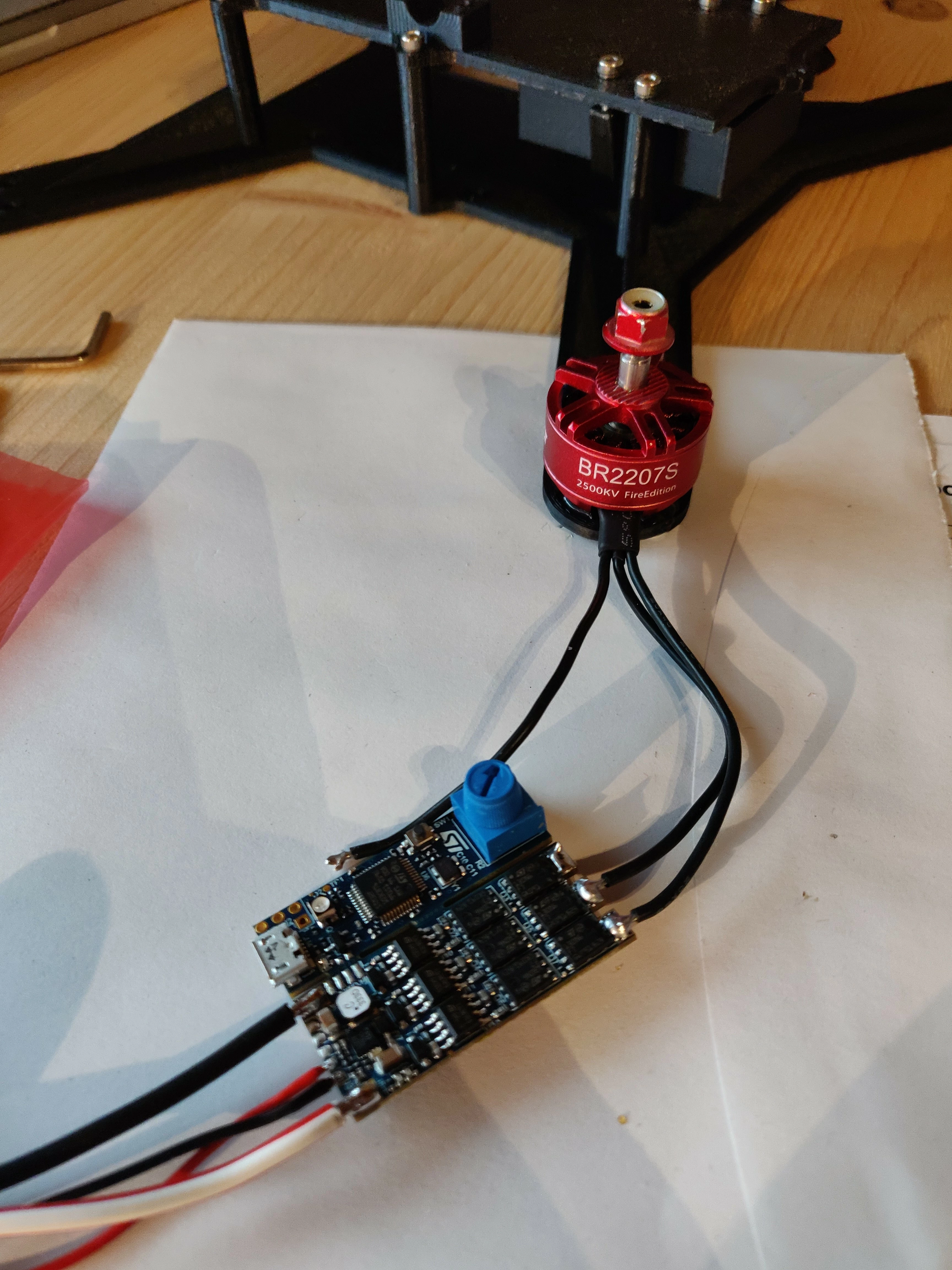

I need to get the Configuration for a Brushless Motor for a Drone (Racerstar 2207S).
I got all the Motor Data and did the first configuration in the MotorControl Workbench 5.4.6. then Generat the files an opend it in the STM32CubeIDL. after that i did a download to the ESC. Now i got the Connection with the Motor Control Workbench.

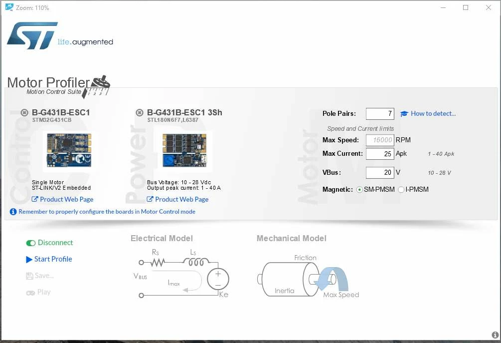

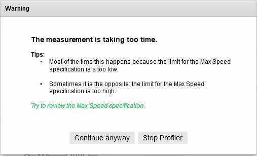

After that i was not sure if I got the Motor Parameters correct. To check that i tryied to the Motor Profiling with the Motor Profiler 5.4.6. After counting the Pole Pairs again (7), and max Current 32.6A I startet the Profiling. The Tool startet the measurment and the Motor startet spinning. that was realy exiting. but by passing around 80% it stops and showd a fault that the measurment is going to long.
When i tryied it again, the bord was getting so hot, with a max of 25Apk that one of de soldered motorwires got off.
