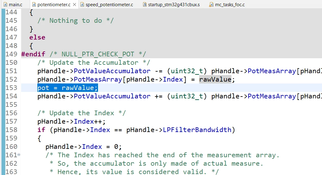

I generated with MC Workbench some code sa use to program an inverter. I want to plot with the monitor the value read from the potentiometer, i.e., the value stored in "rawValue"
I had managed to graphically plot on the monitor "rawValue" variable used only in the two functions "potentiometer.c" and "speed_potentiometer.c" using a variable "pot" declared in main and reported in "potentiometer.c" as external (extern uint16_t pot):
The problem is that when I regenerate the code with the .ioc file .. everything I wrote inside this function (fortunately only two lines) is deleted!
How can I do to avoid this problem?

    Hello @luke514,
    You have to add this code between these two comment lines (see main.c file as example)
    /* USER CODE BEGIN x */
    new lines
    /* USER CODE END x */
    If you agree with the answer, please accept it by clicking on 'Best answer'.Best regards.GMA
