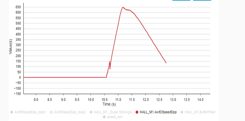

There is always in dip in speed then adjusts itself when i start the motor
STuser2_1-1757576977481.pngspeed dip
I am really not sure of the impact of this but i confirmed that it is happening due to the below transition of the code from if to else in the file hall_speed_pos_fdbk.c
if ((pHandle->BufferFilled < pHandle->SpeedBufferSize) && (wCaptBuf != 0U))
 uint32_t tempReg = (pHandle->PseudoFreqConv / wCaptBuf) * (uint32_t)pHandle->Direction;
 pHandle->AvrElSpeedDpp = (int16_t)tempReg;
 else
 /* Average speed allow to smooth the mechanical sensors misalignement */
 pHandle->AvrElSpeedDpp = (int16_t)((int32_t)pHandle->PseudoFreqConv /
 (pHandle->ElPeriodSum / (int32_t)pHandle- >SpeedBufferSize)); /* Average value */
Could you please confirm if that is the root cause or not, if yes request to please provide me the solution? I need to close these issues and thank you for support.

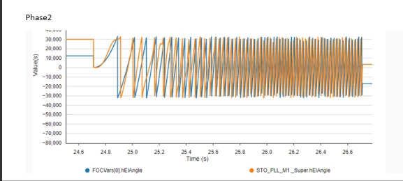

Thank you for the reply, i have not profiled the hall sensors but i have run the profiler software and compared the angles as below
This is done as part of the other issue which is still in progress and not resolved (both are same setup)
Motor Jerks at start and multiple Speed Feedback f... - STMicroelectronics Community
I have followed the method documented in MCSDK to find the placement angle. Please let me know if any actions need to be done from my side.
