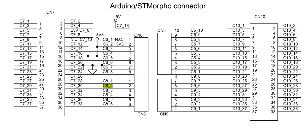

C7_30(PA1) is driven higher voltage than 0.6 by C8_2 .
After removing the connection between C8_2 and C7_30 , the vbus sensing works fine and 0.6v is given to PA1 and motor pilot reads it as 12v.
CAN YOU @GMA  VERIFY AT YOUR END AS WELL .

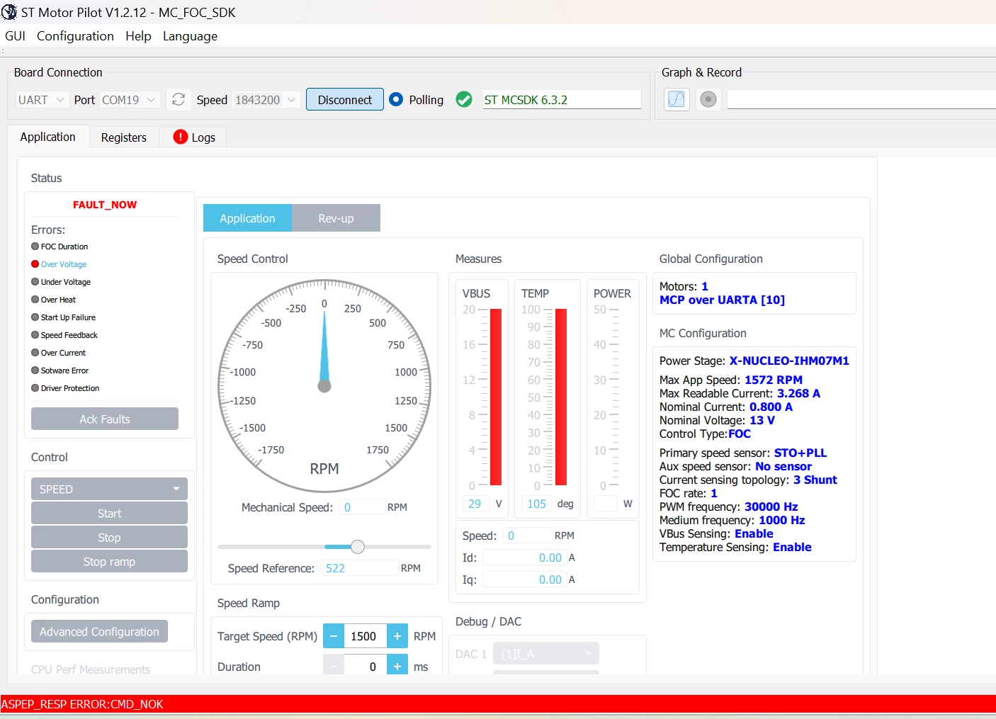

This is the error that pops up when i try to start the motor using motor pilot

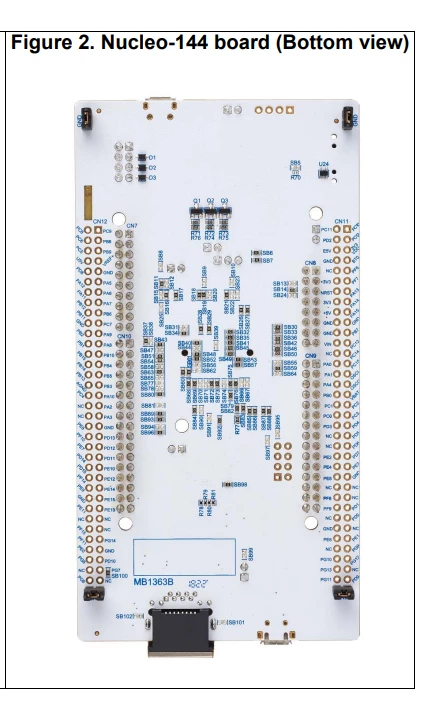

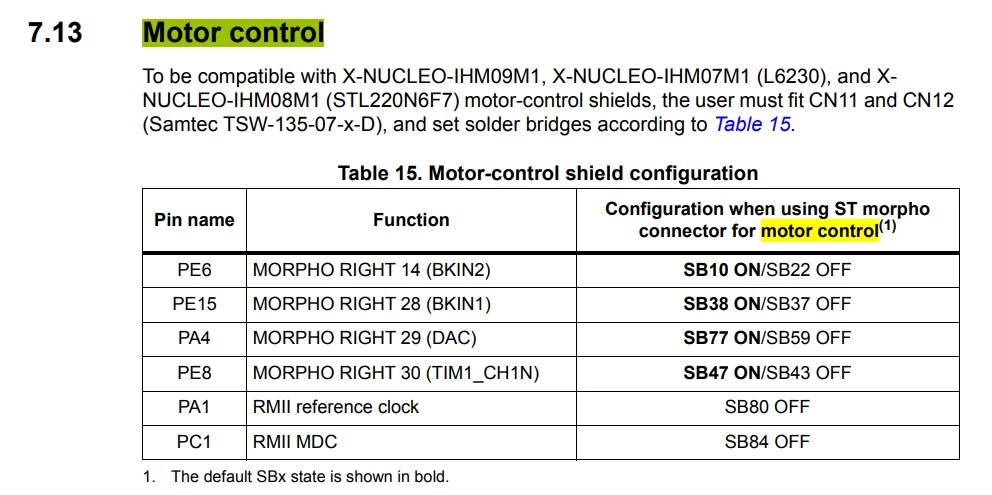

At generation step, you have the following message, SB80 and SB84 have to be removed:
On Pilot GUI, VBUS exceeds 20V and your motor is a 12V. Temperature is also wrong.
As soon an error is reported, it will prevent PWM generation.

Actually i probed the vbus its just 1.5v(PA1) , but in the pilot its measuring as 29v .....And i have removed the sb80 and sb84 before hand..
Mar 12, 2025 7:10 AM UTC
seems like pe15 pa4 pe8 all are reversed , eventhough it's mentioned as SB's mentioned in bold are default...but in the board both conditions are reversed ...can you verify that..?

The behavior of vbus is inconsistent , and temperature sensing seems illogical .
The voltage what i was supplying is 12v and i measured it .it was perfect .
I have attached the video below .
