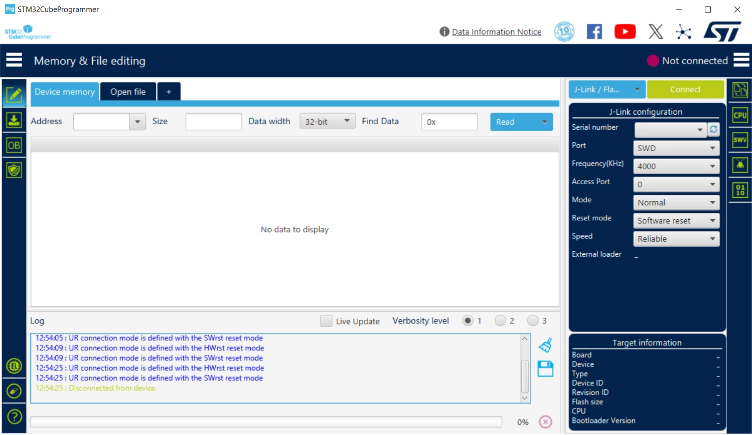

The board appears in Device Manager on my Windows 10 PC, and port/baud rate/parity settings match what is in Motor Pilot and STM32CubeProgrammer. Neither Motor Pilot nor STM32CubeProgrammer will connect to the board. I am using the latest drivers. What am I missing?

I have read all of the getting started guide, and I do not have a firmware upgrade option in STM32CubeProgrammer v2.20:

Select ST-LINK instead of J-Link option.
