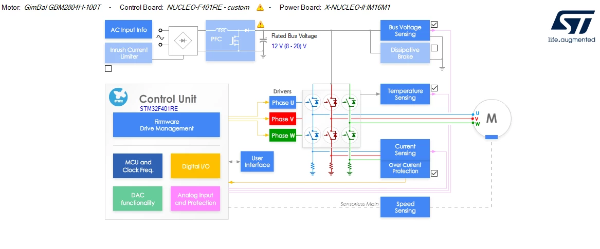

I am unable to perform the operation on my STM nuclio board and IHM03 motor control board.
I have installed the ST motor control SDK,STMcube mx,IAR WB 8. by seeing the video - https://www.youtube.com/watch?v=0g28Ki8adfE
But I have encountered the following errors.

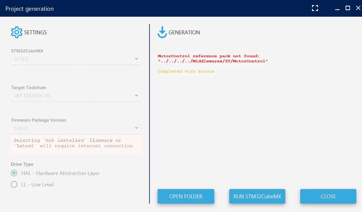

2025-02-25 23:49:31,110 DEBUG [EnvironmentChecker.checkPack] STM32CubeMX.Version: 6.13.0-RC5
2025-02-25 23:49:34,180 ERROR [LineInfo_to_exitCode.manage_MCPackNotFound] MotorControl reference pack not found: "../../../../Middlewares/ST/MotorControl"

Hello @Vivian_Vincent ,
Using MCSDK 5.4 version, as shown at 1:42 in the video, used STM32CubeMx version is 5.2.0 and FW package version is 1.0.0.
Refer to "Release Note" available through "Workbench tool>Documentation" for more details.
If you agree with the answer, please accept it by clicking on 'Best answer'.Best regards.GMA

Hello @Vivian_Vincent,
First, install required STM32CubeMX available here. According to Release Note, up to v6.4.0.
STM32CubeMX6.13 as you are using is not supported.
Launching STM32CubeMx tool, select STM32F4, install FW_F4_V1.26.2
Select these versions for generation.
Feb 27, 2025 11:57 PM UTC
Thanks for giving a detailed procedure.
